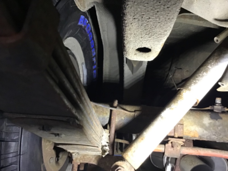

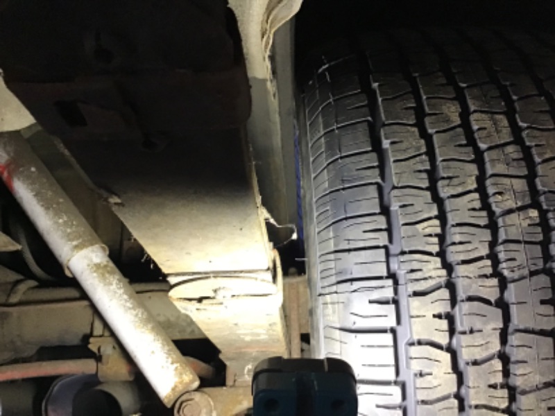

The Nitto looks a bit more street worthy than the MT for certain. And thanks 33 IMP, the gripmax 265 50 looks pretty good, almost an exact copy of a TA. I guess 3/8” really isn’t much less width. I just put 295 50s on it a while back, but haven’t tried it yet. I’m fairly certain that it’s going to rub though
not sure why you think those will rub... You have miles of space there..

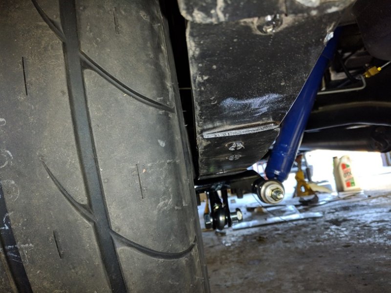

This is mine and hasn't rubbed at all..

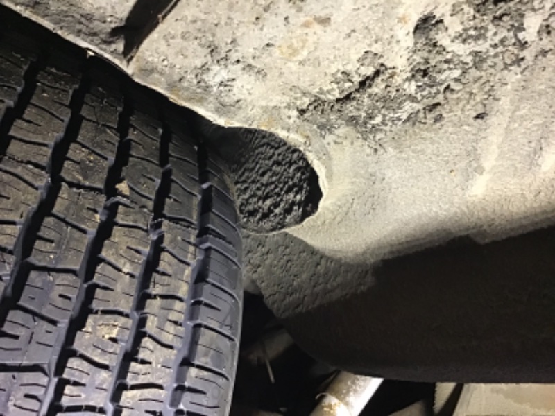

I agree, I think he's okay to the spring, but I think he's worried about the inside lip of the tub. (His top pic).
ah.. saw that and it looks ok to me.. but the camera might lie...
NAw.. he's got at least a inch in there.. he's good
It’s a 69 rr. The reason I’m worried is because when I removed the MT 275 50s, I noticed tire rub marks on the inside of the wheel well. I’m assuming the leafs must flex some.
Maybe just me, but I always seem to have clearance issues to the inner wheel wells before they rub on the leaf springs. A rear sway bar makes a big difference with that issue.
So no leaf flex, but the leaning of the car huh? My car is very stiff. Mopar HD biased springs, KYB shocks and a 3/4 sway bar, so it doesn’t lean much. Maybe the rub marks are from me driving fast with 4 people. I’m gonna drive it soon solo and see if it rubs.
Agree. It's likely not rubbing the spring. My slicks are within 3/8" to the spring, and don't rub. But my car doesn't handle for ship, so it's not likely to rub on the inner fender either.
