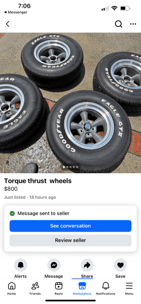

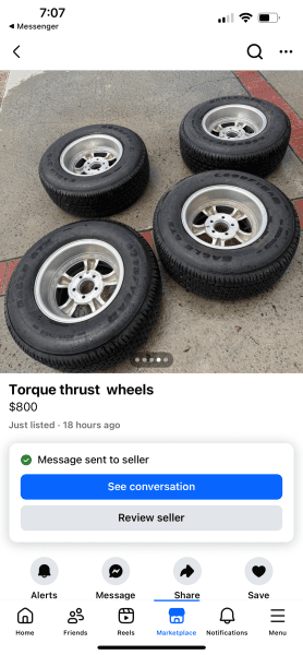

Hi guys I found these on marketplace they are 15 inch wheels 8.5 inches wide 3.75 backspace the tires are 255/70/r15 would these fit my 69 coronet?
Not the front. They would probably look like they do on that Mustang. Good luck turning the wheel!
8.5" too wide on front for sure.

Yea that’s what I figured but just wanted to get you guys’s input

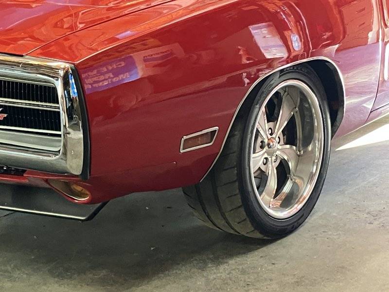

It isn’t the width that poses the problem, it is the offset or back spacing. I have 18 X 9” wheels up front with 4 1/2” back spacing. Mine clear.
It might be safe to say that any more than 4 1/2” FRONT spacing would interfere.

They would probably fit okay all around, IF, (a big if!) they had 4.5-4.75 backspace.
Since they don't, they dont..
I have a couple pairs of 15x8 1/2 rims with 3.5" bs. The won't fit anything I own with correct size tires on them.
