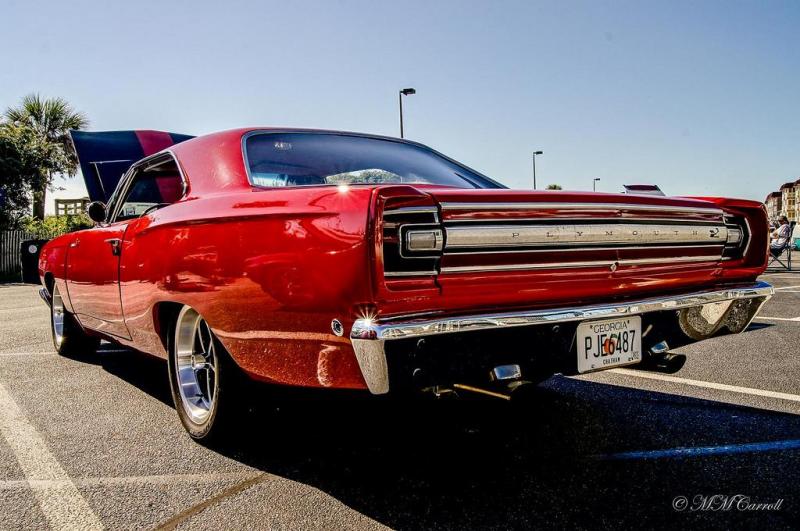

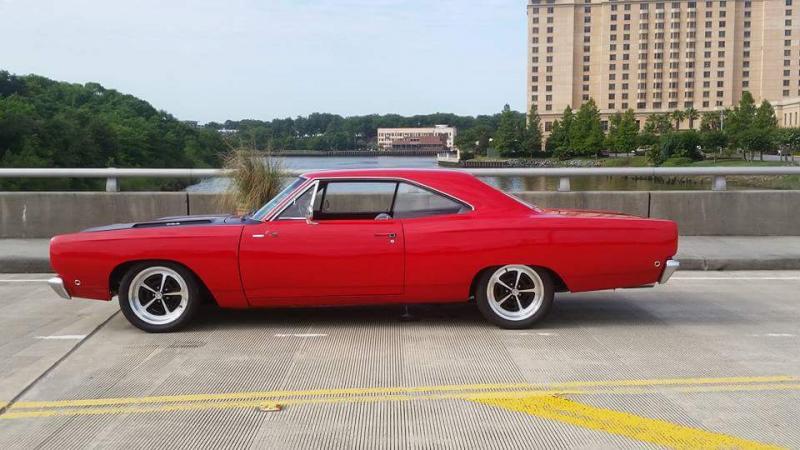

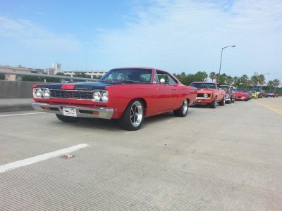

I have 17 x 9 all the way around. 275 45 front and 285 45 rear. They fit perfect, no rub.
Bee, heres a couple o have from the side like you wanted.
