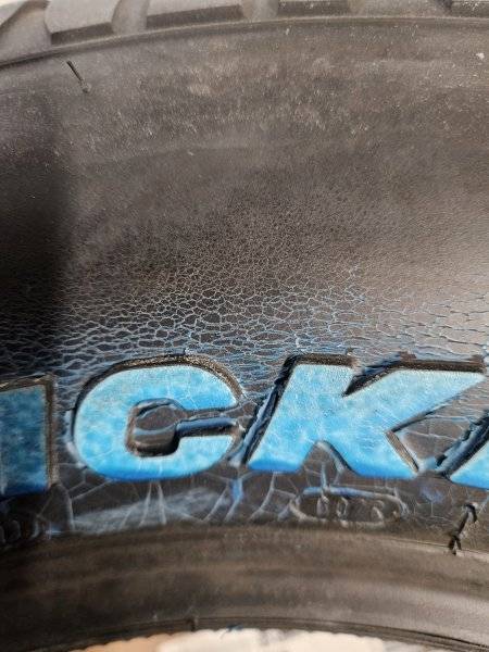

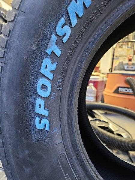

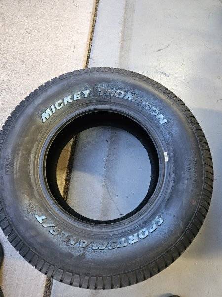

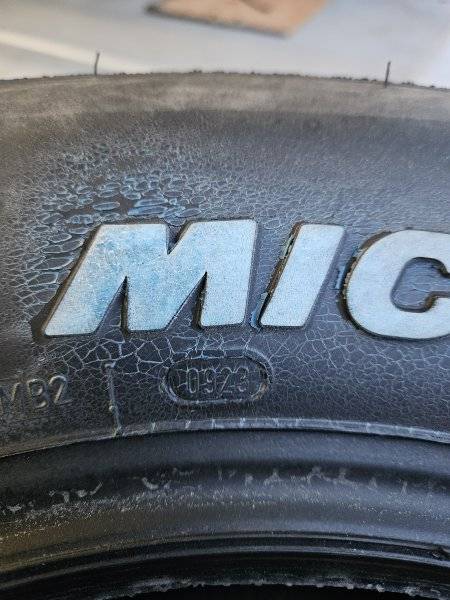

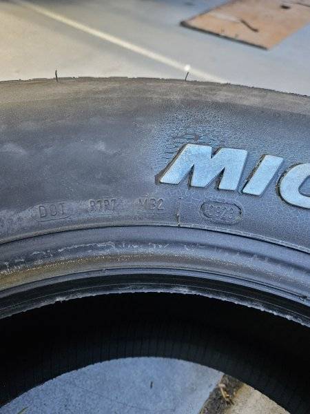

Wanted to go with a different brand tire other than BFG Radial TA so bought tires from Summit.
I spoke with Summit rep before purchase and she told me they rotate out their tires every 90 days - so I bought 2 rear tires in 275/60/15
One tire was manufactured in Nov 22 and the other March 23
Also when looking at where blue dye is on sidewall it looks like sidewall is beginning to crack
So, do these tires have premature sidewall cracking or is this normal?
Summit said they will take tires back
Your thoughts?
looks like the blue spray is cracking, tires look OK
Sooo, one tire is 2 years old, the other is almost 3? So much for rotating the stock. I would send em back and insist on “new tires”, sometime in the 24 or 25 years.

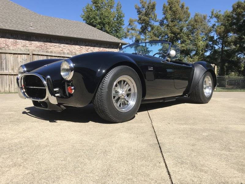

Those appear to be Mickey Thompson S/T tires which are the same as Cooper Cobras. I run them on my ERA Cobra Roadster, black side out. Excellent tires.
As I understand it, the M/Ts are based on a Goodyear casing and are made here and the Coopers are made in mexico. At least thats how it was.
[way cool Cobra btw!]

So Mickeys are good tires ….
Looks like the DOT manufacturer date
Was 9th month of 2023 .
Their is no cracking of the tire shown !
There is apparent coating of the White
Lettering your speaking of …
“ Roll Em & Smoke Em “ …..

Blue spray cracking? Nothing wrong with tires in my opinion.
:thumbsup: yep the BLUE soap sealer, they put on for storage
so they don't get black mares on the raised white letters
It washes off, not really an issue,
even a few (5) months or maybe near a year different between casing/casting dates,
not a big deal
as long as they aren't already 3 years old or something
Send them back if you want a newer casting date
you may have to wait a while, supply & demand
