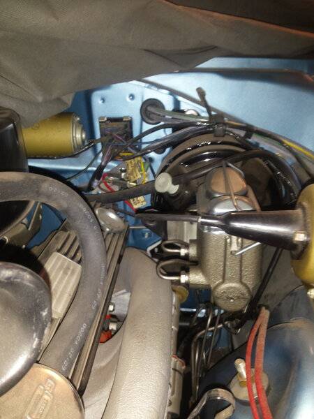

my 69 charger R/T came with the brake lines on the engine side of the master cylinder. And since I live in Florida, it gets pretty hot here. Has anybody used a master cylinder with the lines located on the opposite side? And is a master cylinder even available for a bendix disc brake car on the opposite side. Or am I over thinking it ? Or maybe a heat shield?
Will it boil the brake fluid? To me it looks unsafe. As soon as that engine moves up. It will crack the line. From what I see.
Yeah, I'd put a heat barrier of some kind between the two surfaces!
There's plenty of turbulent air moving around in the engine compartment
but the radiant heat from that exhaust manifold would worry me.
All my cars have the ports on the fender side of the master. I think that is a better setup than what you have.
It looks very close ! I've not seen a master with lines on other side ! A heat shield might be a good idea ! How much room is actually there ?
If a mc isn't available with fittings on the driver's side could you possibly use high temp spark plug boot heat shield sleeves?
I measured 1.5" above the exhaust manifold..and I found a new master cylinder in my shop with the ports on the opposite side. But I don't think it's for disc brakes, as both reservoirs are small. I'll have to do some research. And I found a nice chrome one on ebay that looks oem but it's $80. And then I would need to make or buy some new hard lines.

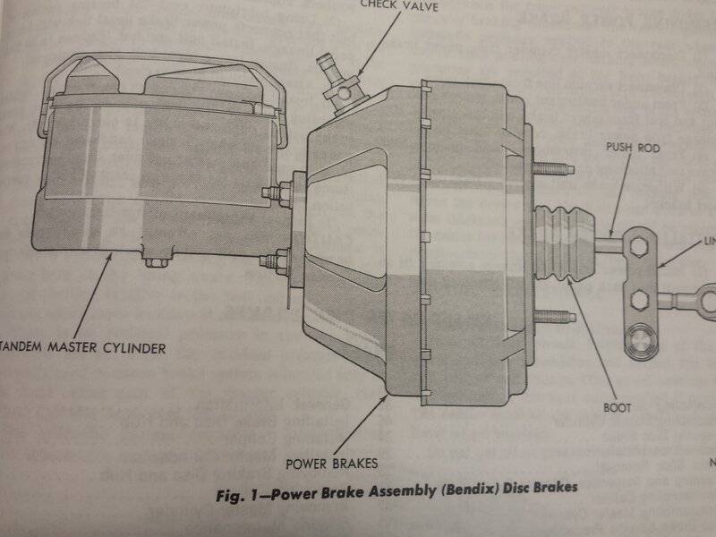

My 69 service manual shows it on the passenger side or engine side . But there is room on the drivers side, If I can get all the parts to make it work correctly.

As noted in my picture above your car is a stock set up just like my 11/69 mfg '70 Bird. Not an issue, running regular old brake fluid.

It came from the factory this way . And I shouldn't have any problems but I wish it wasn't so close. I plan to get different master cylinder and some new hard lines for it in the future, just to be extra safe with this heat in Florida..

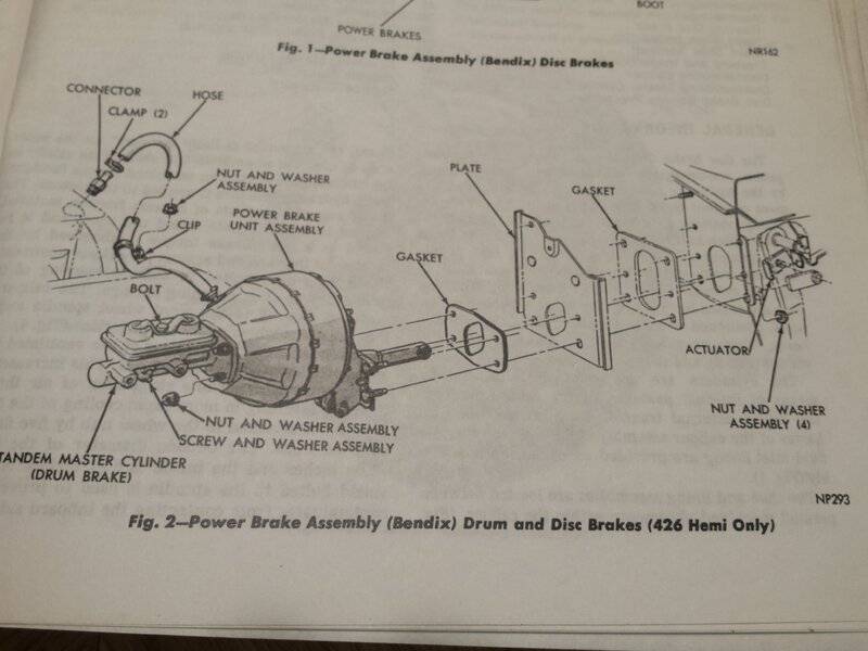

The hemi master cylinder had outlets on the opposite side, didn't it?
Or don't I remember that correctly...
