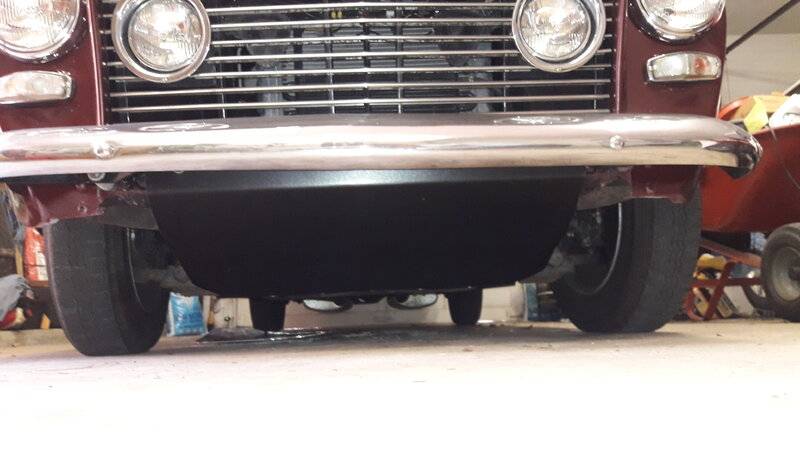

but a previous owner fitted a metal tray to mine
to hide the visible suspension. Might it help cool the engine bay if I take it off?
David
David
Help a ton, I'd say - but then, you have the old aesthetic, aero and noise issues the original "look" has.
Me, I'd yank that dang pan off of there.

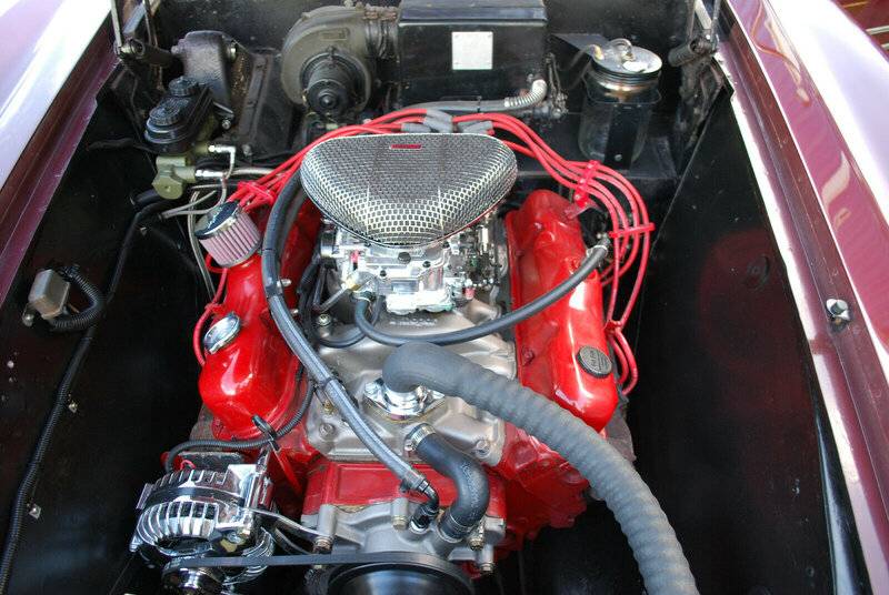

The issue is that you have a tight engine bay that gets alot of heat.
That heat is migrating thru the firewall.
Any way to evacuate the heat from the engine bay will be a big improvement.
Any consideration to remove the inner fenders? or at least put some openings in them to help get rid of heat?
