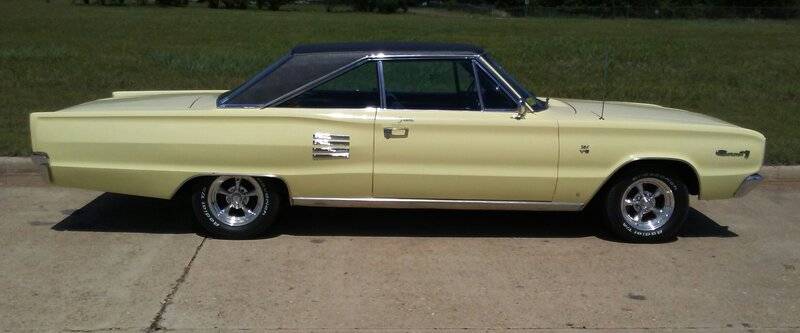

I developed a couple of "easy-to-fix" problems on my Coronet back in October '20. After a 345-mile day at speeds from 30 to about 85, the brakes were very wonky. It felt like there were no fronts at all! Parked it, then took it out for a close-by cars & coffee-type event. The brakes were still kinda wonky, so I drove it home and parked it for a bit. I bled the complete system, with zero positive results. Tried another couple of times. Still crap. Long story short, the master cylinder was toast.
Last week, I replaced the master after bench-bleeding that, then bled the system again with all-new fluid. Still not right. Better, but not 100%. There is air in there, somewhere. Screw it. I called a buddy with a pro shop and asked him to check it all out and bleed it. I bleed brakes the old-fashioned way. He has all the right tools for that. Boom! Now, I have perfectly-functioning brakes and all is right with the world. I've been driving my Imperial convertible to events and such, and had been itching to drive the Coronet again...and it sure feels great to do so!
The other problem was a grounding issue that was making the brake lights not work, or one or the other. Totally random thing. Fixed that...hopefully. I'm just happy to drive it again. Fixing the car was not a high priority, as I had the Imperial and the '68 D100 to drive and enjoy. Sometimes, having another set of unbiased eyeballs look at something helps a lot.
