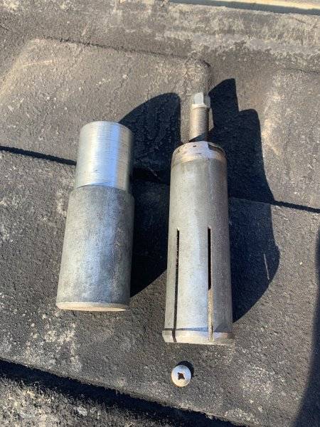

Tool for tailshaft bushing removal 833
Best I remember Mopar used to make one. Similar to this
Yep i have one takes just a few minutes to remove and install a tail shaft bushing under the car. Ed and I done his a few years ago went smooth as silk!
Sure did!
Do you know the part number for that one?

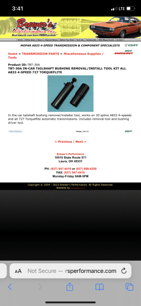

can’t find a part number on either one
all I see on brewers are tools if the extension housing is removed
Did you see my Brewers link in post #11? I have that tool from them and replaced the tail bushing in my A833 in the car and fully functional.
