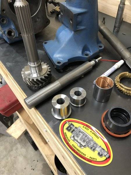

Isn't there a tool made to pull the tailshaft bushing from an 833 4spd without removing the housing? looking online and checked Brewers I'm not finding what I'm looking for.

Pretty sure you will need to pull the housing off. If someone does make such tools I am sure the cost will give you butt pucker.
Brewers has them, and the bushing and seal.
Pulling the tailstock off is a real pain in the ***. You may as well pull the whole trans out so you can comfortably work on it on a bench. Getting those rollers in on the input shaft and then getting the tailstock maneuvered back in ... not a job I'd want to be doing overhead. Maybe the cost of the tool to pull the bushing isn't too bad after all !!
It took me about 30 minutes, stress free, to use "the tool" out and in. I am almost tempted to sell "the tool" now. I dont think I will ever need it again. But maybe...

Just bring it to a transmission shop and have then remove and replace it. I had the local transmission shop do mine and wouldn’t let me pay them for doing it. The only difference is that I had the tailshaft housing removed from the transmission.
I bought one from brewers, works well!
