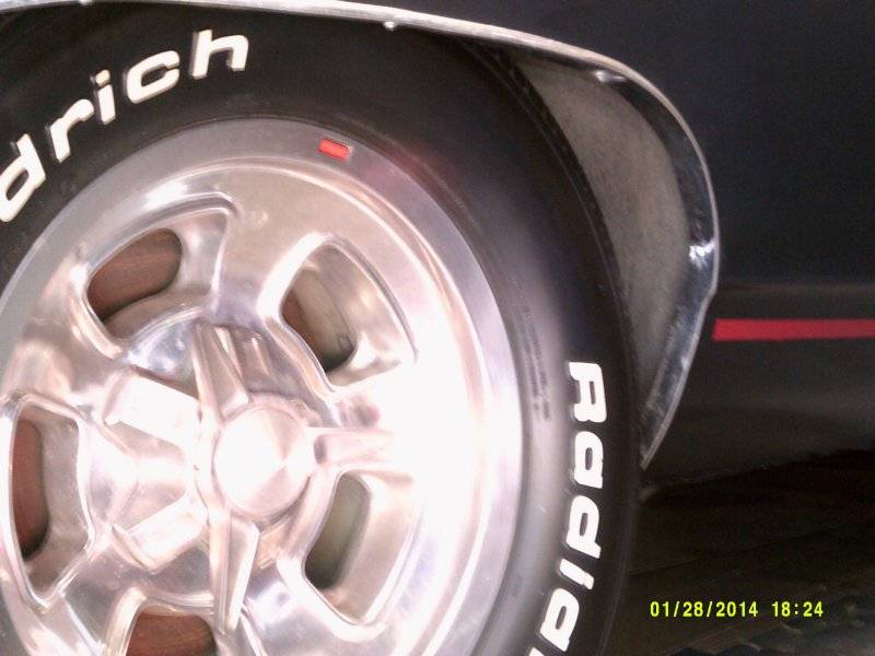

BFG P245/60R15 front 15x8" (mounting surface is like 7"s) frt 4"BS
no clearance issues front at all, Edelbrock, Halibrand Kidney Slot vintage knockoffs (no longer made)

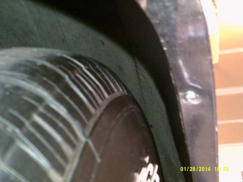

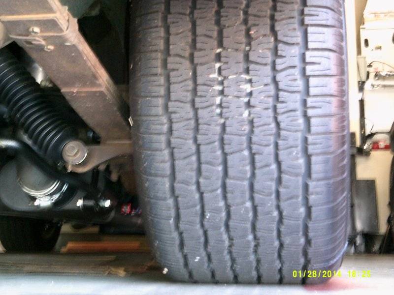

BFG P295/50R15 rear 15x9.5" (mounting surface is like 8.5"s) rear 5"BS
68 RR 295-50-15 Edelbrock Rear Wheels & Tires 15in x 9.5in. 5.25in BS #1.JPG
68 RR 295-50-15 Radial TA on Edelbrock 15 x 9.5in w-5in BS outer lip clearances.JPG
