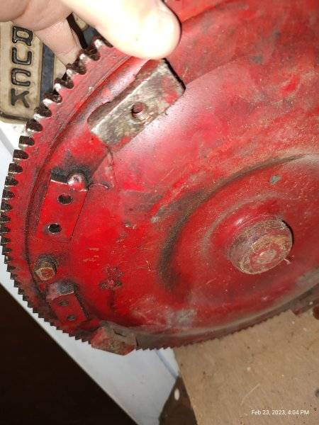

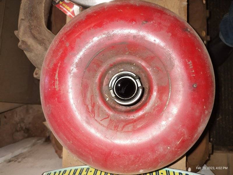

Pics. I'm thinking this came off a '73 440 GTX back in the early '90s. Has the counterweights.
Looks like the weights were added on later.
But yes, 440 weights
