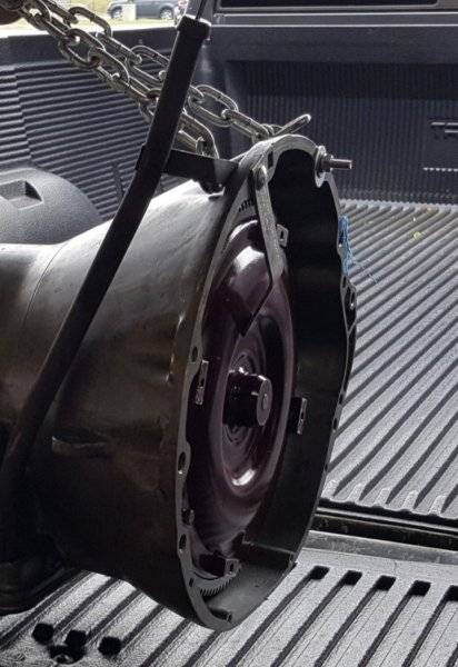

Torque Converter Seated?
Do you have an old one to put it beside?
The 66 and down have a different spline.
What year is the Trans?
Count the splines on the input shaft.
Right, I counted 24 splines, so I figure it's the newer version of the 727?
If the convertor slid on as far as it has, it's got the correct splines. Sometimes they are just difficult to get down on the pump lugs.

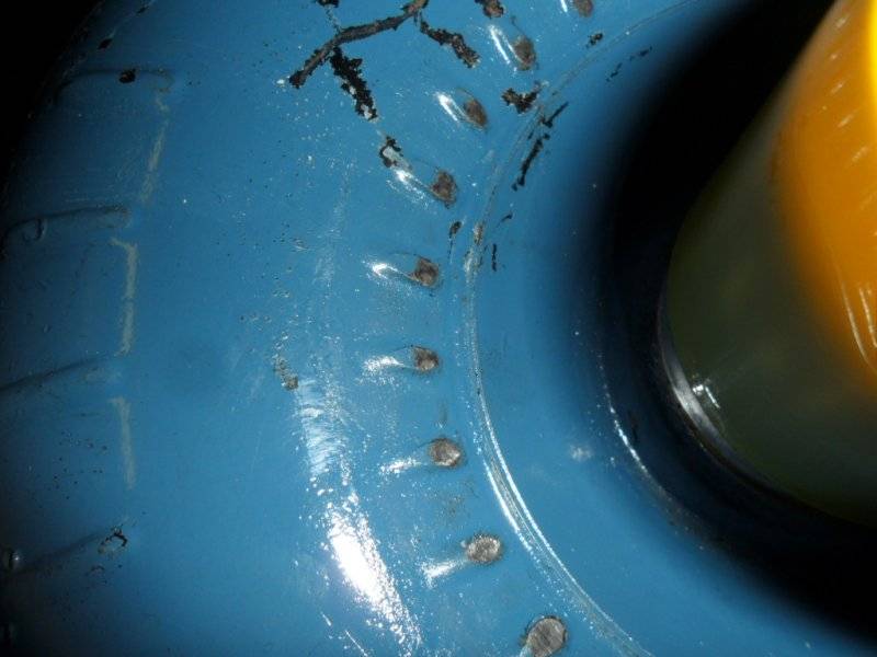

As I mentioned, some aftermarket convertors contact the front pump. Here is one of mine that required the pump to be removed and cut on a lathe. Note the wear ring witness rub mark I created by placing the convertor in the trans with it set on end and applying hand pressure while rotating the convertor. After machining the pump it went in about 3/4" further and worked fine.
My first B&M 10" Street/Strip convertor slid in "all the way" however it did contact the pump housing as the pics show. I had to grind a bit off the pump housing for clearance. But that doesn't seem to be the issue the OP is having.
And make yourself some sort of bracket to hold it in place until you get it close to bolting the trans up. They like to fall right back out if you're not careful.
I like to use one of the inspection cover bolt holes on the bottom.
That way you can wait until everything is bolted up because those holes don't get used until later and then remove your bracket or 3/8" box wrench which works pretty nicely.
Does someone have a converter, that they know will fit a 727, that they would be kind enough to measure the pump lug slots for me? I measured the slots on my new converter and they measure .400" (both of them).
Well, you guys were right. After a lot of lining things up and jiggling, twisting, even the planets finally lined up as well and the converter dropped right in! Checked the measurements between the mount pads to the bell housing compared to the flexplate to the back of the block, I will have 1/8" gap when the trans is mounted to the block. Thanks for all the advise.
