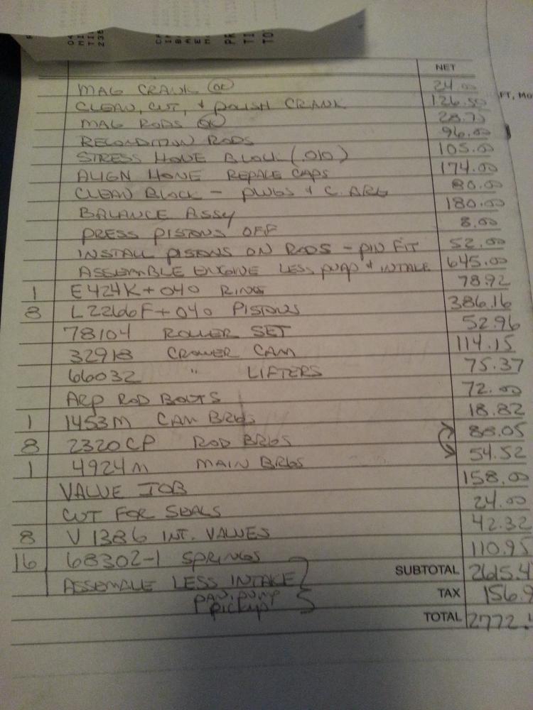

It's been 10 yrs since the build. I have no idea but I am going to assume stock? Here is the build sheet from PO.
Sealed Power E424K Rings
Sealed Power Camshaft Bearings 1453M
Sealed Power 4924M Crankshaft Main bearing
Speed Pro Forged alum Pistons L2266F
SA Gear Double Roller 250 78104
CROWER Stage 3 32918 HYDRAULIC FLAT TAPPET CAMSHAFT - .444 Int (1.5R), .467 Ex (1.5R) Lift,
Crower 66032 hydraulic lifters
ARP Rod Bolts
Sealed Power V1386 Valves
Crower Single Vale 68302 Springs
Well, if you have the factory rockers there is no adjustment. If there is a noise it may need to be run to pump up, if that doesn't do it more diagnosis will be required
