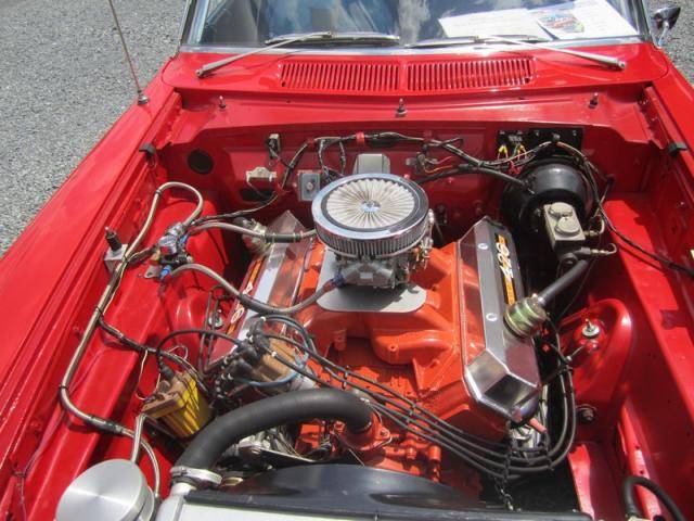

Well it never hurts to have back up. I use a solid steel motor mount on the drivers side since I race sometimes but I still have the chain on it since I had it on before the solid mount. It cant hurt any and if you plan to race the car then its nice backup. If your not going to race it and put sticky tires on it then you really dont need the backup. You can see the small chain I have as backup on the drivers side front of the eng. Ron
