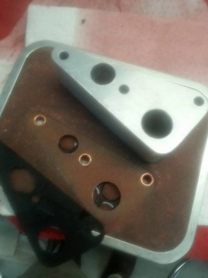

  • The as found picture clearly shows the filter was correct, two suction holes, but the B&M extension and gasket only had a hole for the forward pump suction. This arrangement completely isolated the rear pump in my early (1962-65) a-727, causing severe shifting problems.

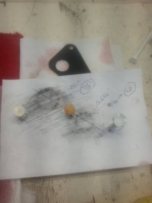

  • The methodology picture shows how I used a rubbing of the correct filter, used golf tees through the screw holes to locate everything accurately and then center punch through the rubbing paper to locate the new 5/8" hole through the extension. I also made a matching hole in the gasket.

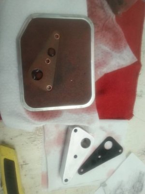

  • The after modification picture shows the new 5/8" passage in thee extension and gasket. Short test drive showed upshift problem solved.
