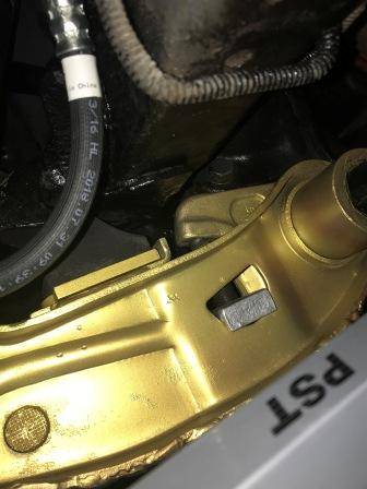

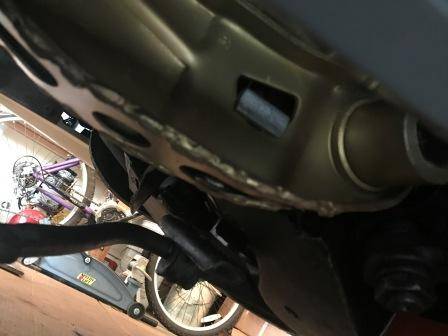

Can you get a picture of where the adjusters are now with the ride height like you want it. Inquiring minds want to know. Mine usually end up even with the control arms, maybe just a little more in.
Usually mine do the same but I did a car awhile back that had one sticking down a good bit more than the other and after pulling them both out, one was longer than the other!

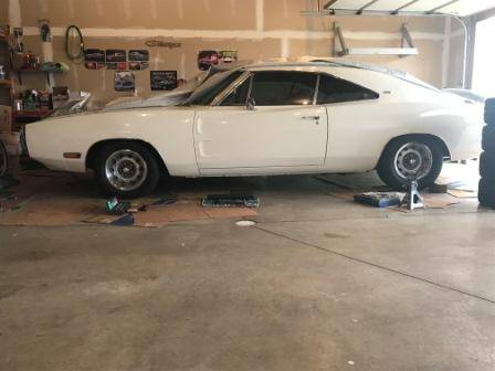

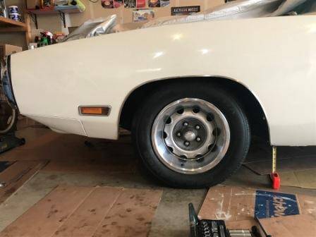

Here are some pictures. Might be hard to see, but the top of the head of the adjusting bolt is almost even with the bottom of the LCA.
