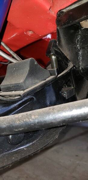

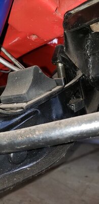

UCA bump stop, not the LCA. Sometimes you need it out of the way to get the LCA low enough, but can usually pull it down to get them in. Out is another story in many cases.

This. Remove the UCA bump stop, & shock off the LCA. Pull the suspension down as far as you can to insert the bar into the LCA.

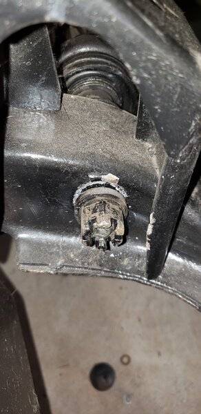

Ok I backed off the adjustment screw all the way, removed the spring clip. clamped the bar but it won't come out? do you let the suspension hang or support it with a jack? they
were just put in about a year ago.
Might have some tension on it still. Is the UCA contacting the bump stop? Did you remove the shock bolt? Both of those will stop it from releasing all the tension even though the adjuster is loose. Careful how you clamp it as well...vise grips work, not ideal, but use cardboard or wood to prevent gouging the bar.
It’s also possible the suspension is now hanging just a little lower than the point where they can slide directly in/out and are completely free of torsion - causing them to bind a little. If installed on the wrong sides this could definitely be a possibility. If you have a helper, remove the tire and have them slowly lift up on the spindle a little while you try to pull the bar out of the socket. If they were just put in a year ago and were greased up when they were installed, they should just slide out with a little tug once the torsion force is off them. Otherwise whack the clamp towards the rear with a mallet.

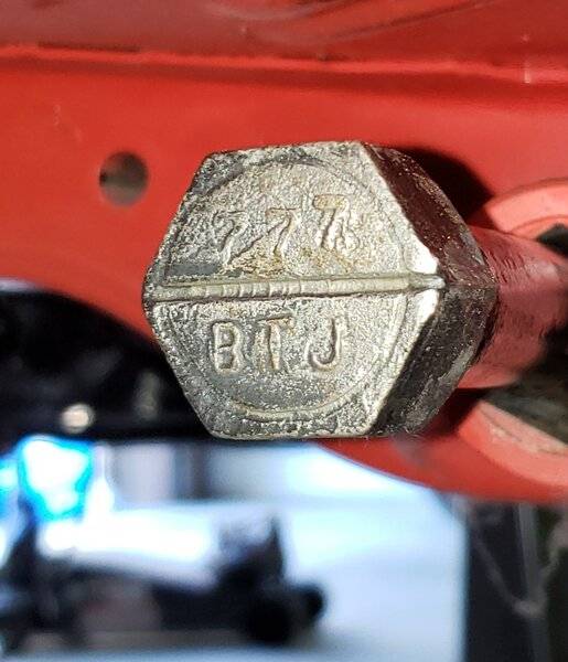

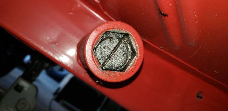

ok .... by loosing the LCA nut and 2 or 3 whacks with a center punch the bar fell out. Thanks for the help. Here is the bar stamping. Does any one know the code on what this means. The bar is out of the RT
pass side of car. I believe I marked them RT/LT when I removed them.
Next I will clock it correct per the first part of this thread.

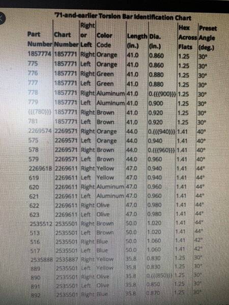

777 is the left side bar according to google info I looked up. Don’t tighten the nut back up until the bar is back in and full weight on the suspension.
OK so the bar is on the wrong side. it was on the RT pass side? I looked at the LT drivers side and see it 776R ... so I will swap them.... that could of cost me all kinds of issues ... Thanks
Glad you got it figured out, and for future reference, with Mopar parts numbers where side-to-side orientation matters, an odd part number is always left (or driver side), and an even part number is always right (or passenger side). So 777 would be left, 776 right.
