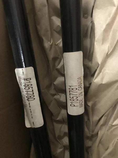

i had my front end apart last year i reused the old ones , but i just bought a set from my local chrysler dealer for 180 Canadian. so im happy will swapping them out easy cause i had them out last year.
there si a right and left , and is there front and back ??, i will need to look in shop manual if they say anything about that tomorrow. last year mine came out easy after being in there for 50 years
but its a low miler and saw no salt.

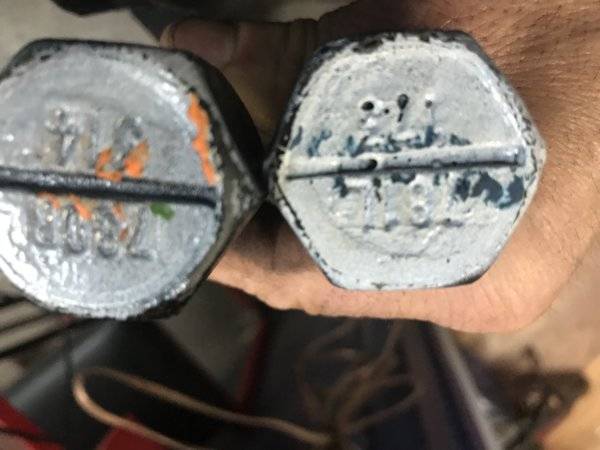

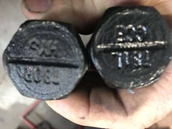

Are those stock, or aftermarket? Okay, you say stock.
Of the half dozen sets I've put in, none were marks on both ends! All up to the late 60s.
Must be 'new and improved'!
All kidding aside...in your other post, I described how to check them. If there's any question about it, that's the way to find out. Those bars 'should' be made with a pre-twist in them, clocked hex ends, and only go in one way. Simply because there made to twist in one direction only.
Will add, I suppose there's always the chance, end to end, right to left, maybe the clocking is the same direction, for each side. You tell me...and we'll both know!
If so, won't make any dif.
