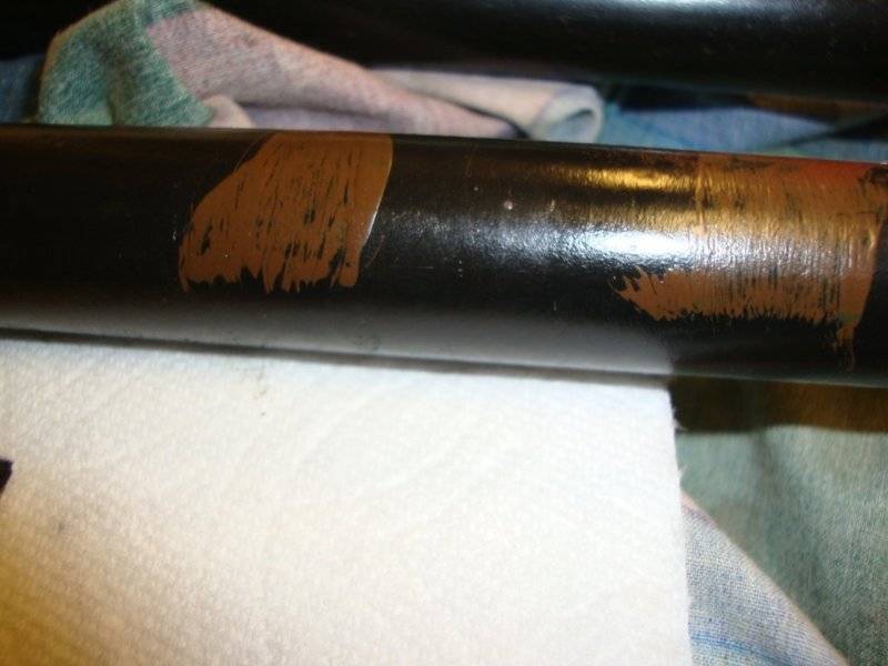

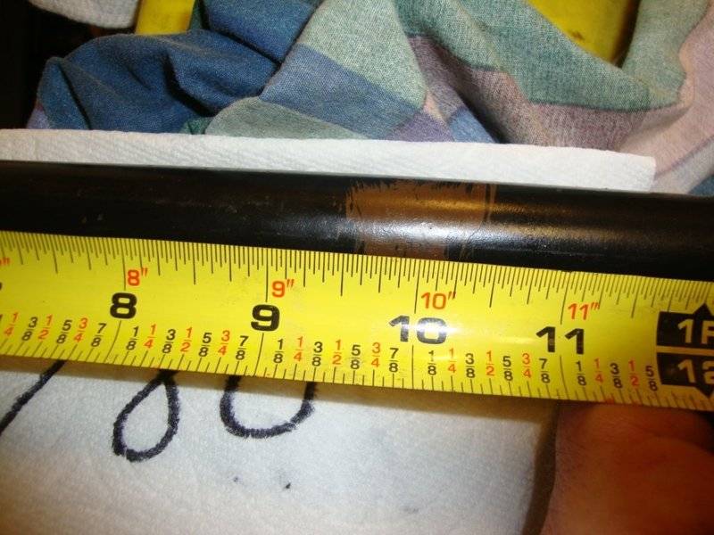

The factory placed a brownish stripe one bar had one strip and the other two stripes. That was a quick easy identification for the line workers to denote left from right with mass production......
A single white mark on each is to point to the left and right marks on the bars and if that is not the case some other reason....
All the older stock bars I've worked with, one bar had a green mark on it. That one was for the right/passenger side. The R and L marks on one end of each bar, I always found towards the rear.
Green?.....Original bars here from a 60k mile documented car prior to restoration.......

Never have seen markings like in your photos. What year??
69......67-70 had brown marks.....other years I am not familiar with..
I would think being new they could go to either side paint marks to the rear but I would mark them so they dont get mixed up after useing them.
Hmmm, maybe remember wrong, but I rebuilt the front end on my son's 69 Charger. Pretty sure the dab was green. I've done 4 front ends, the torsion bars always the same...all big block bars. Wonder if that has something to do with it...the size bar?
