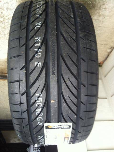

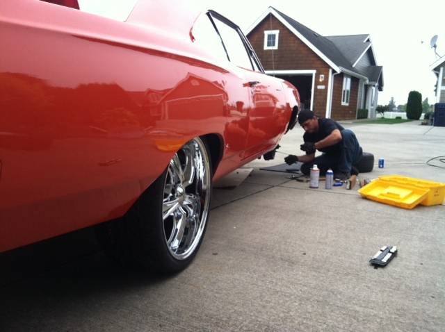

I got some new rims for my car... and the install has been an education. I had to pull the front hubs and replace the front wheel studs because they were not long enough for my application.

There is no way that any lug nuts would grab.
It wasn't that difficult to do...minus the Washington Sky determining that it would be a good time to unload some rain during the install.
I'm eventually getting the Alterkation front end...but wanted to put on the new rims in the mean time. Went with 18" front / 20" rear.
Need to drop the front so that it doesn't look so much like a gasser...
