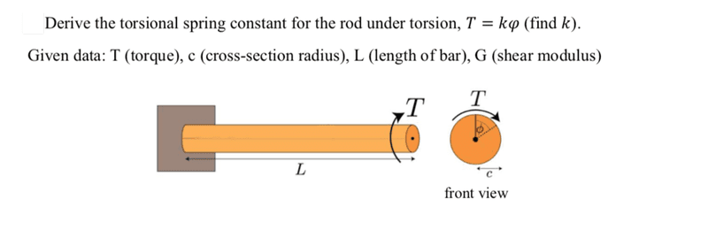

I'm pretty sure that a 1.0" bar is more than 10%stiffer than a .9"bar . I'll bet @RJRENTON knows the math. (My guess is that a 1.03 bar is at least half again as stiff as a .920)
At your request...
Torsion spring torque is calculated the same way you calculate a working load. To calculate the torque of a torsional spring you must divide the spring rate by the amount of degrees of deflection your spring will be required to travel.
is a constant with units of newton-meters / radian, variously called the spring's torsion coefficient, torsion elastic modulus, rate, or just spring constant, equal to the change in torque required to twist the spring through an angle of 1 radian. It is analogous to the spring constant of a linear spring.
Question: ■Derive The Torsional Spring Constant For The Rod Under Torsion, T = K@t Find K). Given Data: T (torque), C (cross-section Radius), L (length Of Bar), G (shear Modulus) Front View
Short answer.....the diameter of the bar plus how many degrees of rotation are the major factors. Since the diameter of the bar is increased, yes, the bar will be more resistsnt to twist but in order to accurately compare the two examples, one must figure the spring rate of the first bar then factor the percentage of the increase in two examples...spring rate is a linear relationship ..... the increase in area results in an increase in the spring constant assuming the identical degrees of rotation. Hopefully this answers you question.

RJ, in your formula is the shear modulus a function of the steel alloy & temper? It appears this math presumes the steel is the same for any different cross sectional area.
I assumed the shear modulus is a constant with regard to the alloy and temper, not exactly knowing those variables. As this question delt with a larger x-section and not knowing the degrees of deflection the bar was subjected to, I made those assumptions....perhaps taking a few liberties....? Maybe akin to the selection of valve springs....wire diameter, alloy, number of active coils, free length, spring constant, installed height, compressed height.....change one variable and the overall characteristics change.....? Just a thought....

Bob, that's why I said the bar size is not the only thing to consider, especially comparing Mopar T bars to aftermarket.
