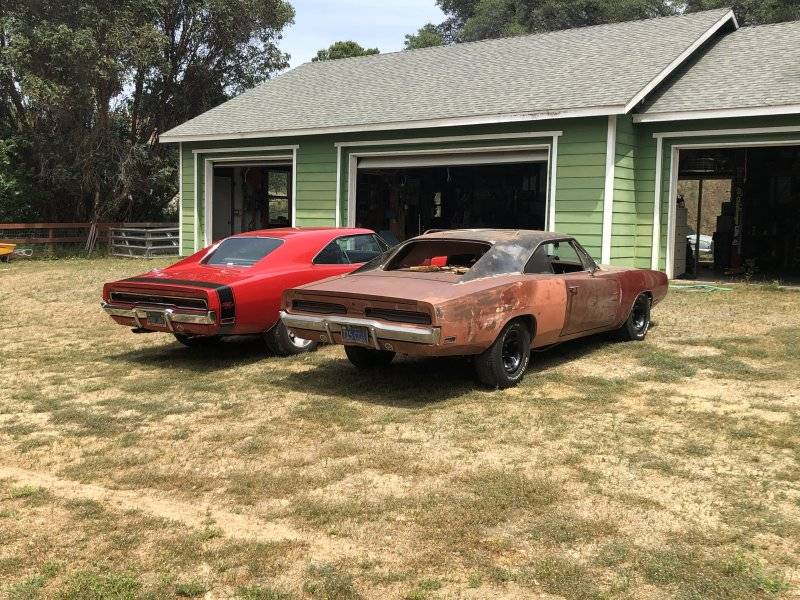

Here Is what I know:
Torsion bar stiffness and a soft or harsh ride absolutely vary depending on what shocks you are using.
I have the stock .88 torsion bars and bullshit KYB shocks in one car and 1.15 bars and Bilstein shocks in the other...
The red car has the bigger bars and shorter sidewalls but rides better due to the better shocks.
