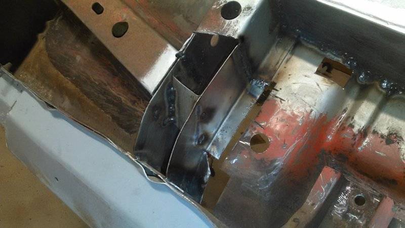

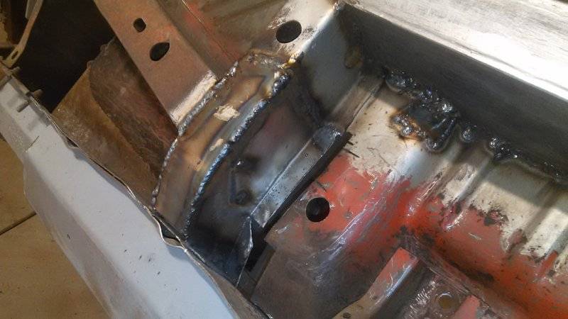

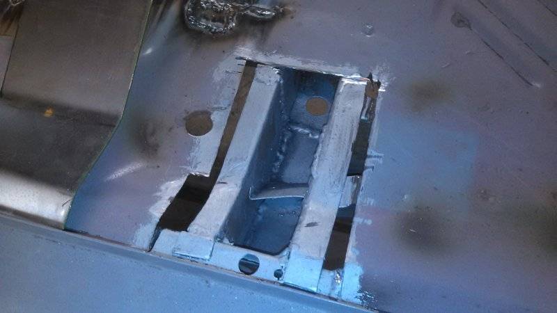

Weve replaced one and saved the floor. Other than alot of drilling cutting and some prying it wasnt rocket science. Like it's been said most of the time the floor may be rotted. Amazingly ours was a convertible and the floor was very nice. If it's only one side I'd splice it as shown above.
Doug
