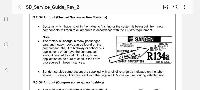

Is there a sticker on the compressor? It states oil fill.
I think you'll be fine 4.5 ounces (135ml) because the oil is mostly for the compressor. It flows through the system, but if that's all they (Sanden website) say you need, they may be right. That compressor is a newer generation, lighter, more efficient, etc.

No, mine did not come with that info on the label, however, I finally dug deep in the Sanden site to find they are only concerned with the the % of pag oil to the volume of refrigerant. The volume of the entire system is not a concern until you get to very long hoses being used in system.They claim that these style compressors are most efficient when pag oil is 3.3 to 8% of charge volume. My compressor came with 4.5 ounces of oil and my target starting point for refrigerant is 41 ounces which will leave me with 11.45%. For each additional ounce of refrigerant added it brings the % down about .5%. When figuring out these values, pag oil must be measured in cc,s and refrigerant measured in grams. Thanks again for responding.
