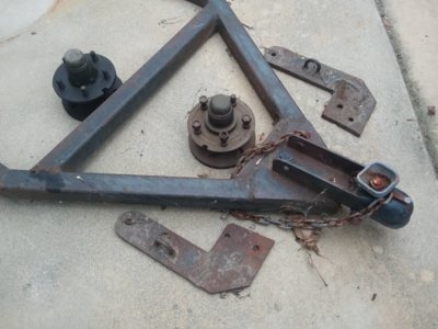

No template but easy, bolted homemade bracket tabs to the bumper bolt frame horns.Now that was 49 years ago.We made our own tow bar to match the width of the tabs. Only photo I got,you can just see 'um.

Mine were just angle iron bolted to the bumper mounts. The tow bar angle iron with the tabs matched to the width of the bumper angles.
Brackets made from 3/8 steel, with a chain loop welded on, two inch 1/8 wall towbar, very heavy, and tow hubs made from amc front hubs with 1/2" plate welded on, drilled for bolt pattern.

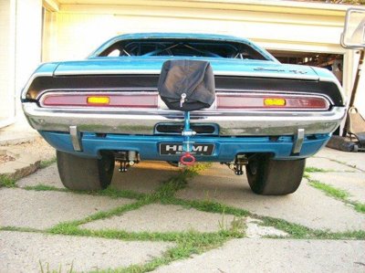

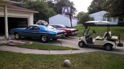

I just welded a hoop to the front of my lower core support which is now 2x2 boxed tubing, not the original sheet metal pulling at the race track with golf cart. Of course this is not for flat towing on major roadways. Also made a push mount on the chute and push bar for golf cart as well.
