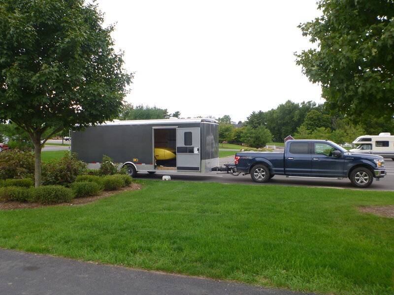

Works just fine... long wheel base, factory tow/brake controller and a weight distribution hitch and go...

Camping at the Gilmore Museum. Notice how the truck and trailer are both sitting level and the truck box is full of supplies as well.

How much toung weight do you have with that bird in the trailer? Is that a 24 footer?

Tongue weight downzero... couldn't tell you as I didn't weigh it. Spread axle trailer and loaded right over them. Tongue weight probably not much different than the trailer empty.... but just enough so it never "wags the tail".
