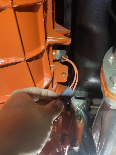

Has anyone wired up/spliced in the reverse light in their TR6060 swap to new American autowire wire harness.
I have included a pic of what I believe is the reverse light connection.
Just wire in the factory harness. You will need to source the connector to plug into your switch connector. Or just find a 2 pin Deutsch Connector.
On the TKO install the factory 833 reverse sensor fit into the TKO housing and used the facility harness.
