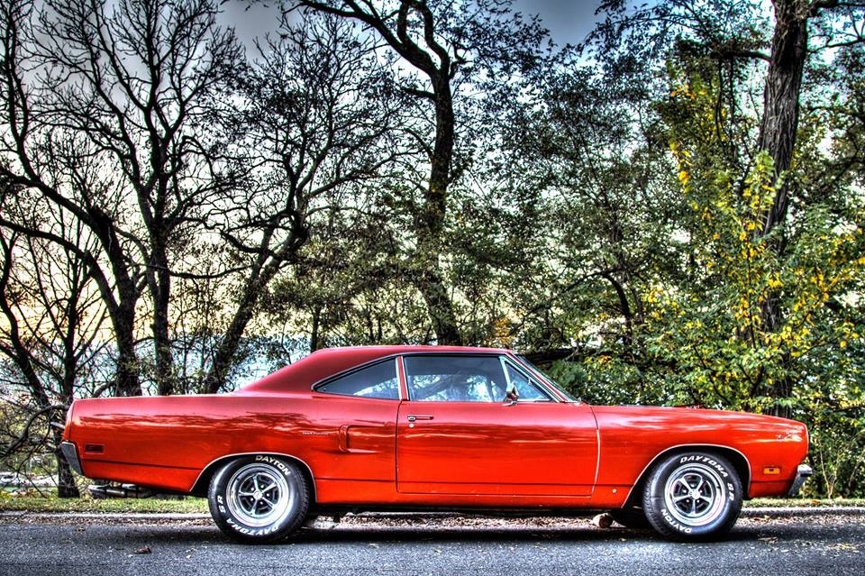

Need a recommendation on getting a pair of Traction Bars for my 1969 RR. Major wheel hop with this new 440 !!!
