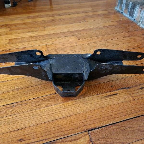

This trans crossmember came in a box of parts when I bought my truck. I see conflicting Info on ebay listings as to what it actually fits. Looks like it's a B body for sure. But I've seen varying info to what year and if it's automatic, 4 speed, or both. It looks like it may have never been installed. Or its amlow mileage take-out. The stamping on bottom is MK 48 3
The 1970 version .looks the same but has smaller mounting holes. The four speed had the mount relocated in 1970, so that it used the same crossmember as the automatic.
So what size are the holes for each fitment? Should I check, or is it 100% a 66-69 automatic crossmember?
