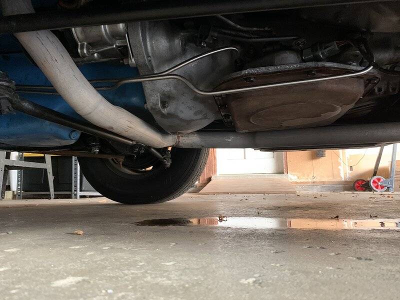

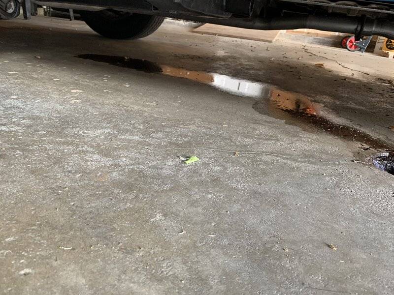

I have posted here and other places for help
My 69 coronet 318/904 combo runs well, but the trans leaks
I have had it rebuilt twice
The second shop had it 4 times last year
It would not leak for a few days
I would drive it and park it, and it would be dry for a few days but tge leak woukd always come back
I decided to research the issue snd found my kickdown linkage was not adjusted properly
I did that, and it appeared I had solved my problem
I went to drive it after a week of it being idle and i find this
Anyone have any ideas?

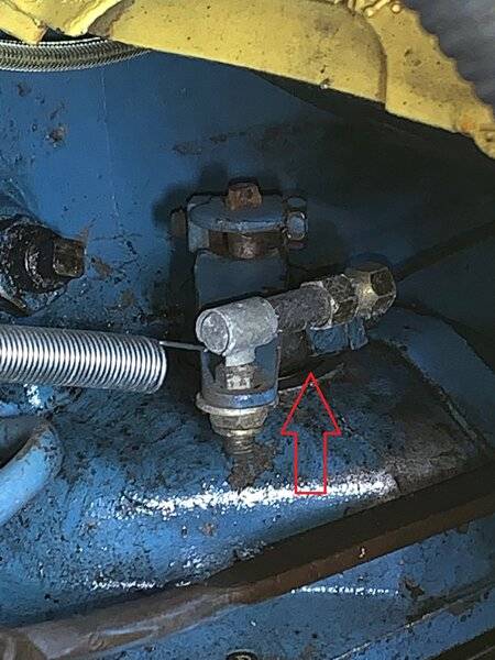

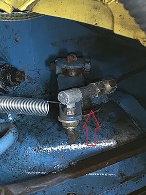

I had a big leak like that. It would appear when the car sat for a while. It turned out to be the shift shaft seal. That's the round seal that your kickdown lever goes through. It's a PIA to fix. I think mine is starting to leak again. Anyway, pic attached.

Shift selector seal is the common culprit. But it should have been replaced during a rebuild. It may have been nicked or the shaft has an imperfection. Cooler lines can do this as well.
