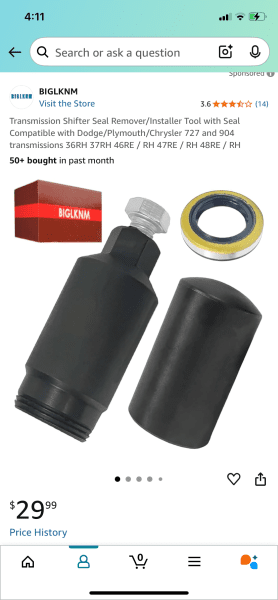

Is there a special tool made to pull the selector shaft seal out of the case or does the valve body have to be removed?
There is a tool for it. Remove and Install
I just ordered this kit from amazon.
Not alot of room to get the tool in
Nice to have in any event
I use a large cap screw and nut with a couple of flat washers to draw the seal into place.
Mike
Showed how in both my Superbird cleanup for Talledega thread, on here, and my 69 Swinger thread on A bodies. Both in the car and the Swinger for extra fun with headers. No special tools, couple of drywall screws .... didn't even pull the Swingers pan.
