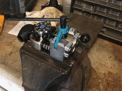

I like the style KD suggests but often I'm doing a flare on the vehicle where there's no chance of mounting in a vise....
I've used one like Carl & KRE Auto suggest, it worked well for me... Not sure what gave Greg trouble...

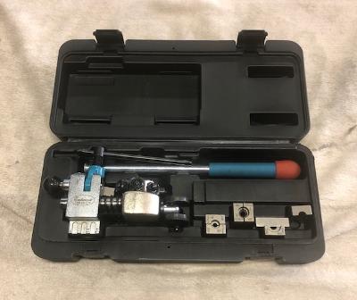

I assume you had trouble with the old school manual flaring tool? Not the hydraulic flaring tool?
Cheap versions of the old school tool suck, an Imperial Eastman works very well if used properly, but there are tricks you need to know...
The hydraulic type in my experience works very well...
