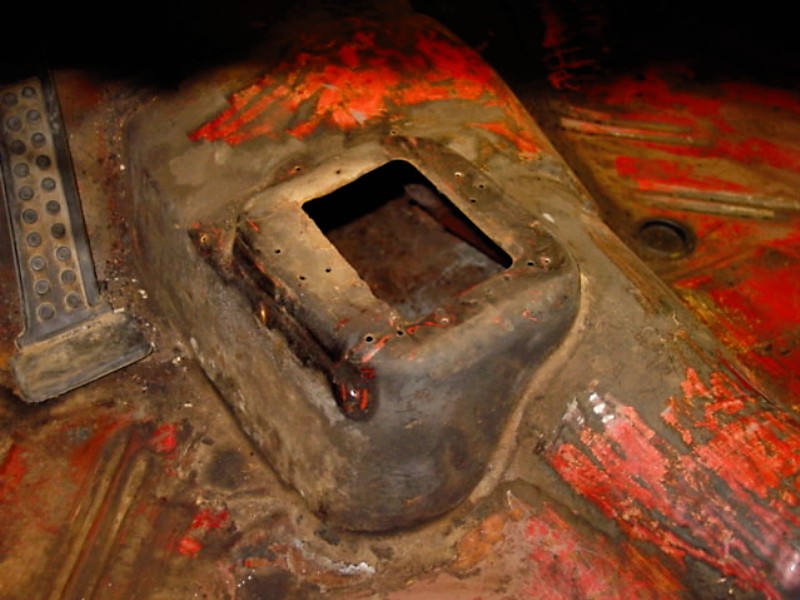

What year is your car? I don't know about pre 1966 but 66-70 the floor pan is formed in such a way that when the original/repo humps were set down on the floor that they "pocket" right into the correct location.
Mine is 1965. I may be wrong, but I think all the early B's (1962-1965) share the same floor panels as well as many other parts.

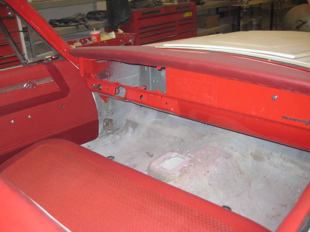

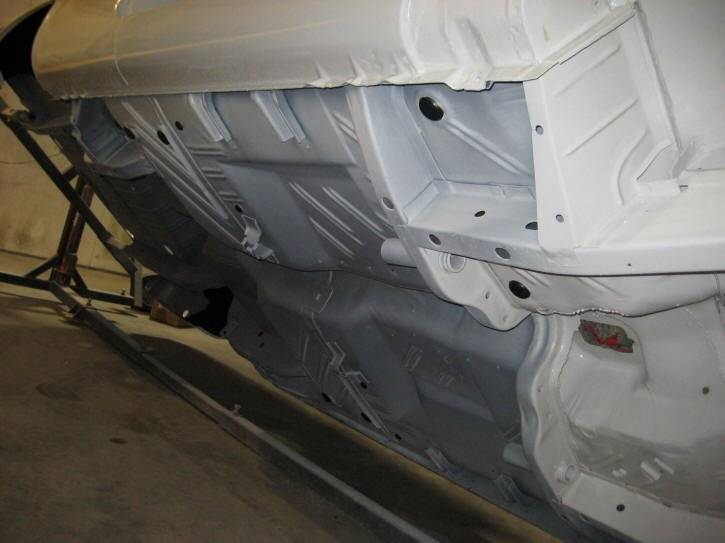

Here are the best shots I have... I can measure for you if it helps. Just let me know what dimensions you're looking for.

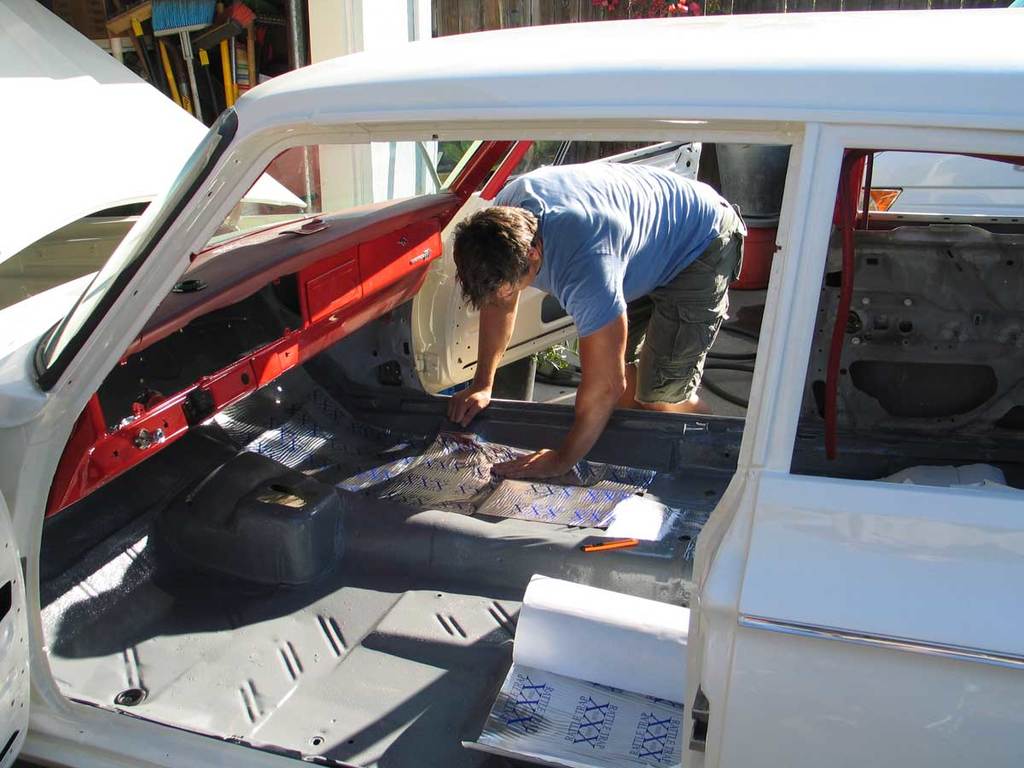

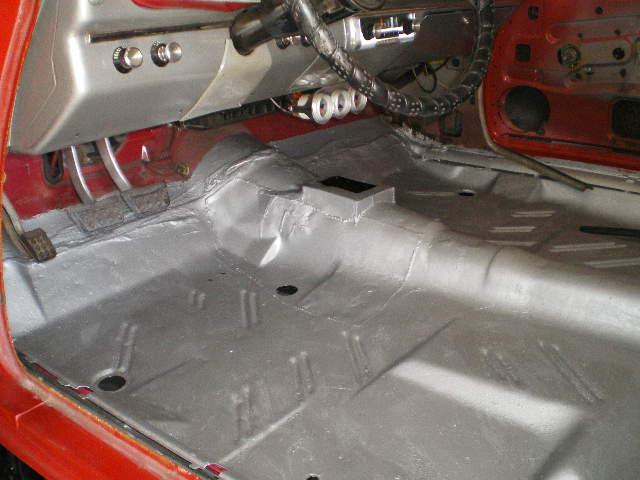

Looks like you cut the original floor pan from the crossmember. I wonder if it would make sense for me to just cut up to the crossmember so that the crossmember remains "boxed"? Sure would like to see an original from the bottom side. I am going to copy your soundproofing too!

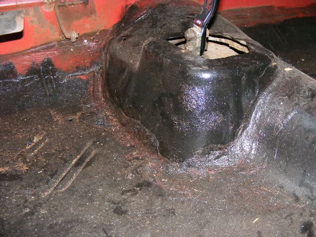

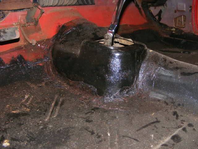

Hey Wedgie- The car is a factory four speed with the original floor still in place.
The pre-65 cars had the same floor whether manual or auto, and when a manual was made they cut the floor and added the hump, just like you see in my car.
I think that if you didn't cut up above the x-member, there wouldn't be room for the shifter's mechanism body.

Thanks guys. I'll make it as close to HitIt's as possible. I'm jealous of his ride anyway.

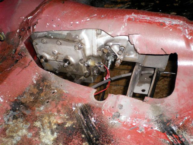

Factory installed hump for '63 T85 car.
