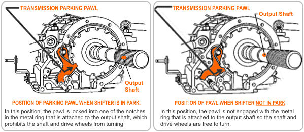

Sounds like it isn't engaging the parking Pawl inside the transmission. Often a linkage adjustment. What kind of shifter do you have? You have to find neutral on the shifter and the transmission as well and adjust the linkage so it connects. I always start my search in 1st. or the lowest shifter position. 1-2-3-N-R-P. Sometimes you adjust from Park and you can't get to manual low. ALso if you have a ratchet shifter, make sure you have enough detents. WHo knows, someone could have used a Powerglide shifter.
Or someone actually snapped off the pawl that engages the notches.
ion.com%2Fwp-content%2Fuploads%2F2019%2F09%2Fe9686848-pawl-in-notin-park_0go07a0gn079000000001-1.png
