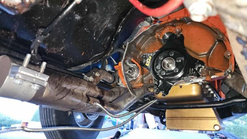

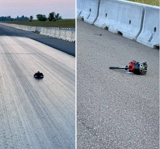

Speaking about transmission carnage. This happened at my local track last Friday night. Picture taken by someone else.
Who’s not thinking drum. I never heard that anyone had found it but perhaps REM knows more. REM??
Yikes, I bet that cleanup took awhile.
The track FB page said that it ended the night. Apparently it happened on the big end.
Last week at Kuhnle a guy oiled it down with atf after the stripe. It was a big old Buick Electra that didn’t look like it had been down the track before. He did it right and pulled off to the side. It still took upwards of 30 minutes to clean up.
It bet that was a thrilling ride to have that exit the vehicle at top speed!
The dude over in the other lane lost a front tire out of the mishap. Was hunting to borrow a spare on Saturday.
He had lost the driveshaft before this. Did that create a sprag issue? Sounds plausible. But it happening down track seems odd? I saw a pic of the back of the motor. About 2 or 3 bolts were holding a small remnant if the bellhousing where the starter goes. I'm kinda wondering if the bellhousing was loose
Sure possible. On Saturday a fellow brought a bolt to me. Looked like a trans mount bolt, 7/16 x .750 NC. They picked it up off the track after my pass. Wasn’t from my car. But I wouldn’t be surprised if it wasn’t part of this deal from the night before.
Yes I'd heard they were still finding lots of stuff.
