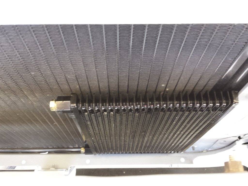

Cooler makers say to mount it in front of radiator and with no more than about a 1/4" gap. Believe it or not, doesn't hurt radiator cooling in any measurable way.

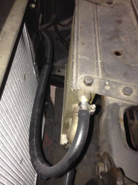

HT is probably right, mine is hanging out by grille but it's an add-on; still using oe rad. cooler. Added mine when racing w/a high stall conv. yrs ago, mines probably 4-5" from rad.

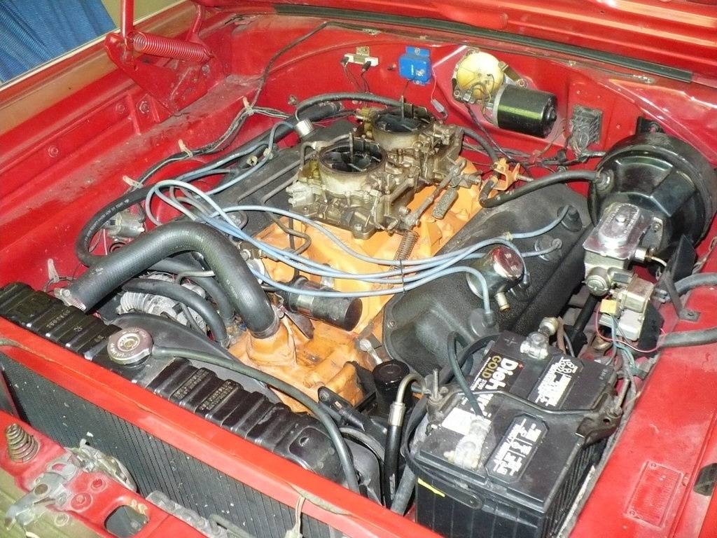

Mines just behind the hood latch cross piece. You can see the upper tubes (look like upside down U's) in the lower left center of picture.

And Fran we didn't need to see ur engine, we were talking trans coolers! Lol

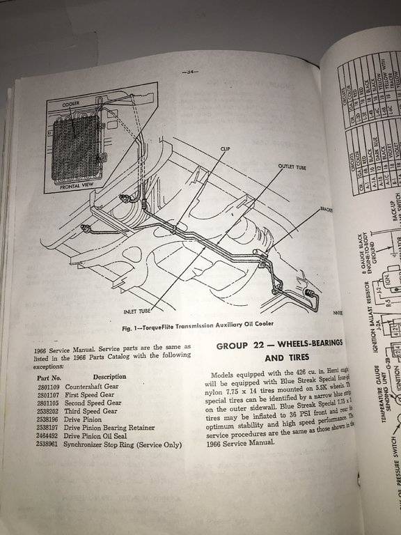

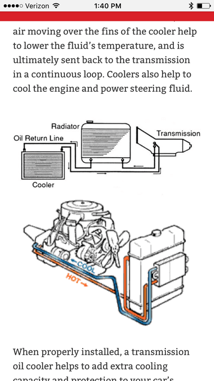

one pic is from factory service manual so i think i'll go with that one. i think both of these pics are telling me the same thing.

Transmission pressure line to radiator
Radiator to upper cooler fitting
Lower cooler fitting return to trans.
Yup I went trans-cooler-radiator-trans.

in that service manual pic i posted, is the transmission pressure line also the one labled "outlet" of the 727?
my 727 lines are set up as pictured in that pic

Really, it doesn't matter so much which order you hook them up, unless you're racing, then I'd say don't hook it up to the radiator at all.
The reason you hook it up to your rad at all is the warm radiator pre-warms your trans. After that, the rad provides cooling really only if the trans over heats above rad temp.
So if you go trans/rad/cooler, the rad will bring the trans to rad temp, then the cooler will knock 20-30 degrees out, so the trans will operate at a temp say 20-30 degrees cooler than rad temp.
If you go trans/cooler/rad, the cooler will knock maybe 20-30 degrees out of your trans fluid, then the rad has final say and will likely add heat to your trans fluid to maintain its operating temp.
