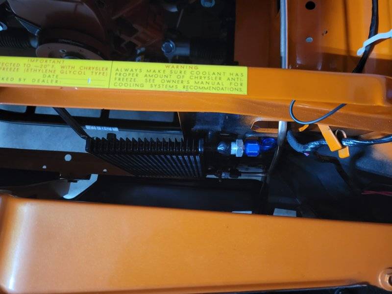

My '71 Charger has the tube/fin type (sort of narrow and long) that is mounted off to the drivers side of the radiator with the long part going up/down and the fittings are at the top, so made custom lines. I don't know what the heatsink looking ones are?
