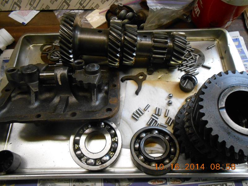

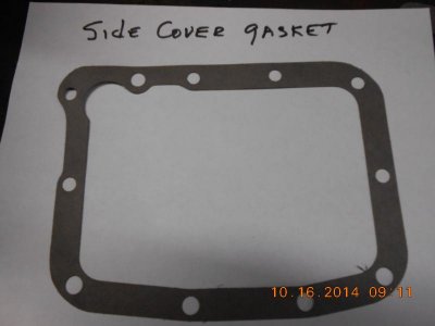

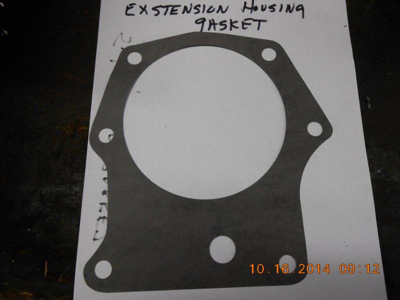

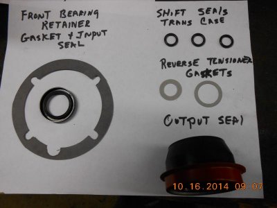

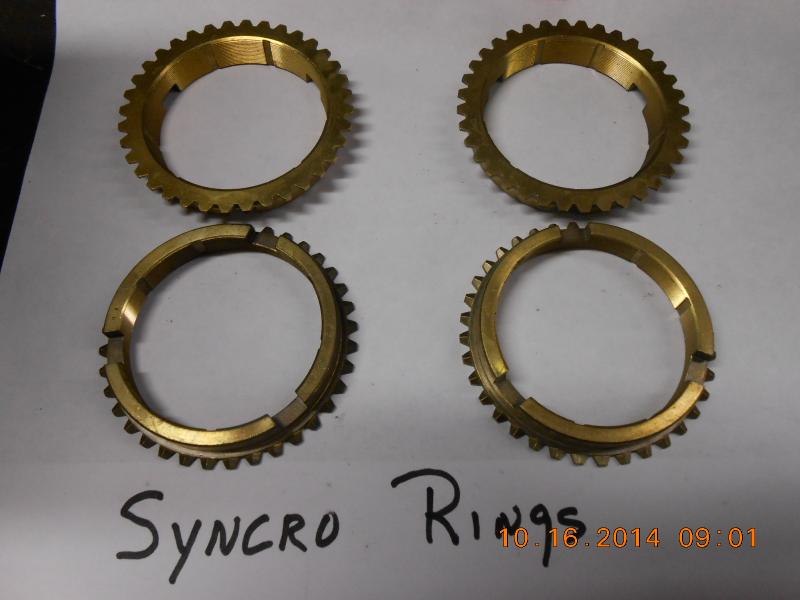

Here are some pictures of the syncronizers,gaskets and seals that I am installing in a 69 roadrunner 833 trans.
There are also 2 seals that go into the speedometer adapter.
The bottom picture is some of the parts that are inside the transmission.
Hope this will help you
Jeff
