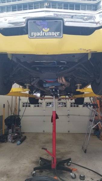

I have a cheapo single stage transmission jack. It is not good quality and the reservoir leaks, but the damn thing is handy as hell. I use it for al kinds of stuff, not just pulling transmissions. For example, lifting a lower control arm to raise it up when working on front suspension, or raising rear axle to work on shimming rear- just to throw out two examples. I even use it to hold my oil catch pan when draining oil when I'm changing oil in my cars. What I am trying to say here is once you have one you will use it for all kinds of stuff under the car.
My suggestion is to get a two stage decent quality lift because it will be that much more useful for different tasks.
Here is a not so great picture of mine:
Note that it is single stage, i.e. there is only one ram that moves up and down so the range it can go up and down is limited.
