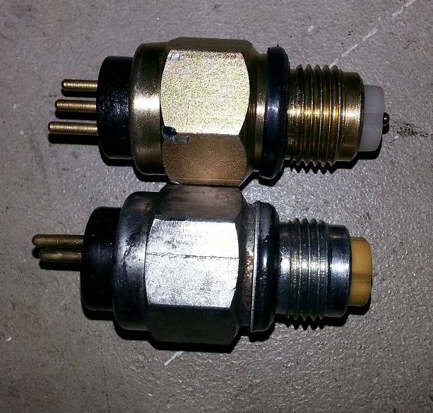

You need to verify that the neutral safety switch is correct for your year transmission. 440'
Good photo above.
also the end of the switch is spring loaded, can you push it in by hand? Or is it stuck? And do you have a gasket on the switch that could space it out a hair more.
OK, good picture. I will verify which lever is in my transmission. Then I will come back to you.
Seems to me the previous owner had a problem with the switch too. There are already 2 gaskets mounted.
Some aftermarket switches are known to be too long.
OK the spring in the switch works easily. I can push it by hand.
My switch does more look like the golden one in the picture above. So what can I do?
Just put a washer or a shim under the switch?
