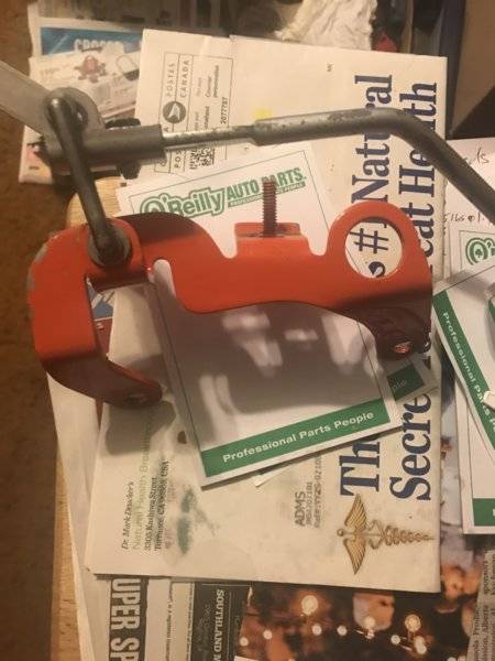

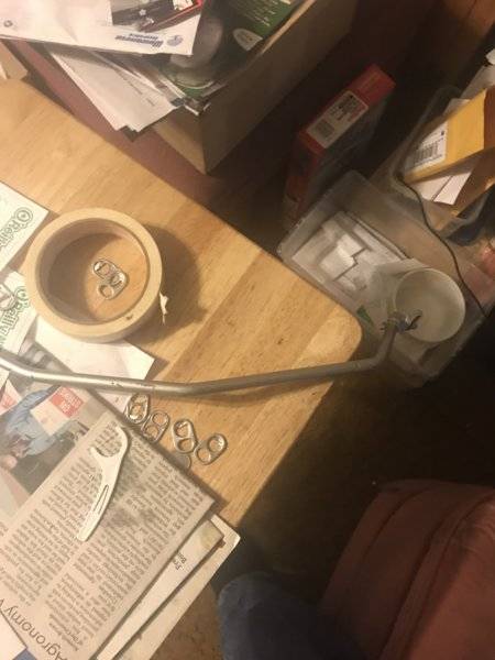

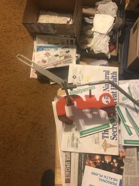

I'm going to have to figure something else out this is not working I'm adjusting it to the instructions and the swivel bracket that the rod attaches to falls forward Hold rod forward loosen nut slide rod back while pushing retainer forward. The end of the slot in the rod isn't even close to the pin.

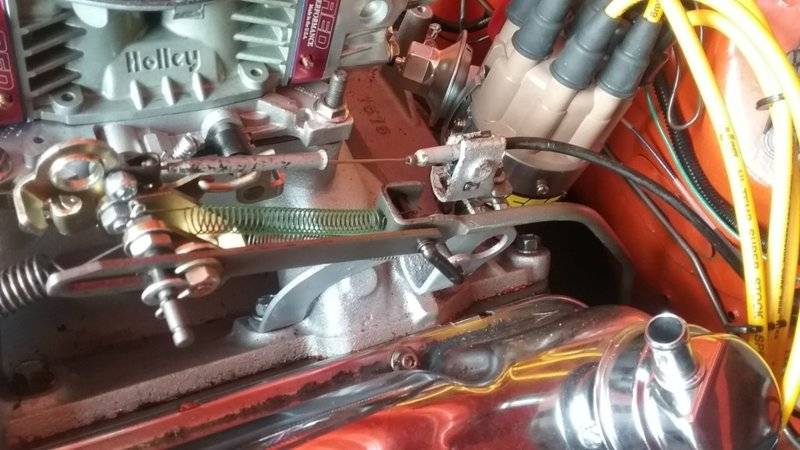

Then u need the 4 bbl set up like this. From a 70 charger 440. Notice how long the top rod with the slot is. I can sell u this if u want it. Kim

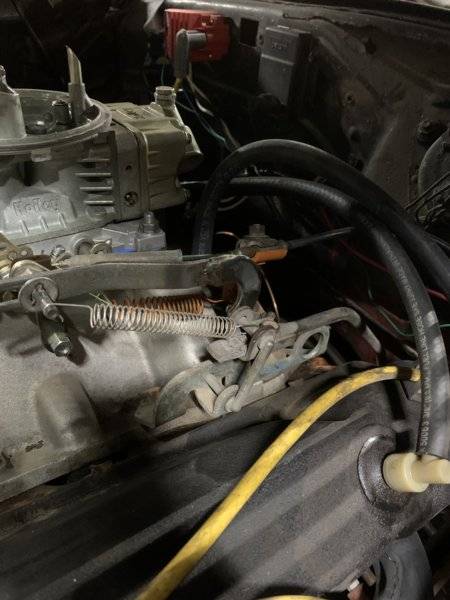

Dam, Idk how I missed 318 with 904. I was thinking big block. Regardless he still needs the proper linkage or install a cable. Also looks like the throttle cable is in the wrong spot, not on the pin. Kim

That's a different animal for sure. Does it look like this one? A cable is an option if you have the right parts on the carb.
