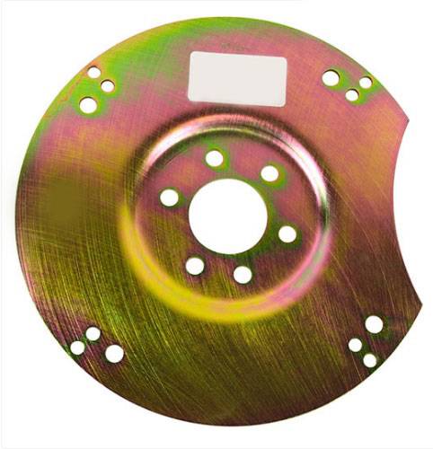

You get the prize. The current TC has no weights. The TF727 was behind a 383 before and when the 440 was installed the TC was not switched. Tomorrow I will change the flex plate out. Hopefully that solves it.
Well, all 383’s will be neutral balanced & a forged crankshaft 440 with small rods (‘66-‘69) will be neutral balanced also. However, “big rod” 440’s (‘70-‘73) and cast crank 440’s (‘74-‘78) will be externally balanced
I installed one of those plates - see the picture - it cured the vibration.
