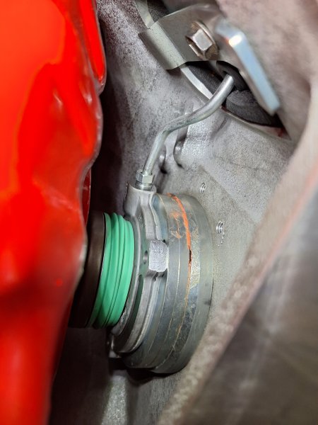

An issue that exists and has been resisting improvement is the clutch pedal feel.

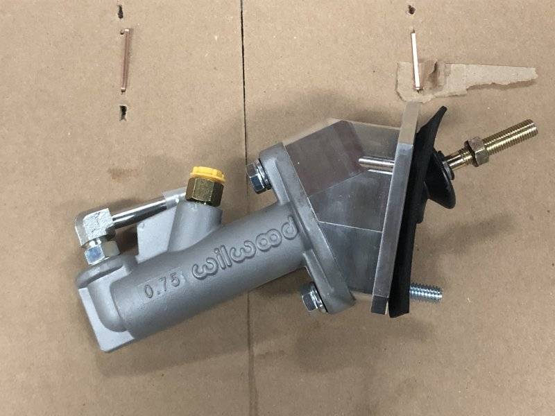

The kit I used in 2021 used a Wilwood .75" master cylinder.
This one is the same size but a different brand.
Mine gives a pedal feel that is the same from top to the bottom. It literally feels like a newer car.

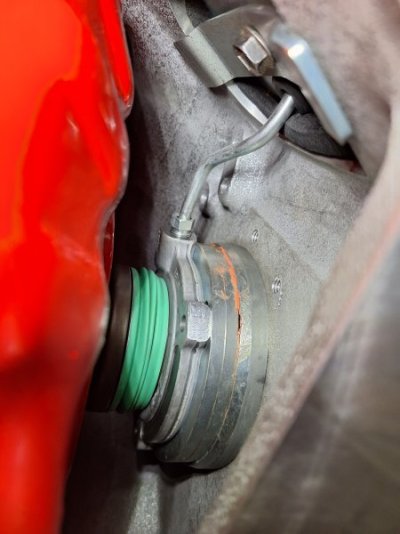

This OBP unit seems to give a mushy feel for the first third of travel, then it firms up for the rest. To me, that seems wrong.
We have bled the system multiple times....at least 10-12 sessions. The last half of those resulted in no change at all in pedal feel.
Also....My kit in 2021 was sent with standard DOT 4 fluid for the clutch master cylinder. The day we started bleeding the clutch, Rich had forgot to bring the fluid so we used the rest of the fluid that came with mine.
Then Rich came over another day with the bottle that came with the kit and it is labeled as being synthetic.
