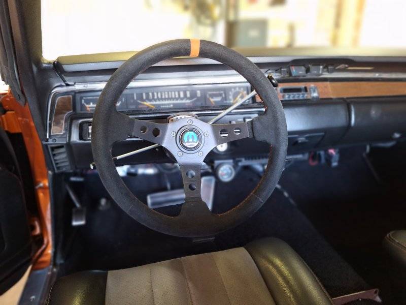

First a short background on the car. It's a 69 Coronet 500, from the factory with a 318 2V, 3 spd auto on the tree with a 3.23 geared, 489 8 3/4". Somewhere along the way a PO swapped in the 440. I bought the car on an Ebay auction back in Sept 2013. I'd already had the Dart and was "just looking at B-bodies". The wife was away for the weekend with her girlfriends, leaving me to my own devices (so it's partly her fault). The car was in Texas with a reserve, so I threw in a figure. Reserve Not Met. Added another $1,000; RNM. I started getting curious, bumping up my bid in $500 increments wondering where this thing would land. Well, I found out; $13,000. Sunday afternoon Maria walks in finding me and two of my car-buddies huddled around my computer screen. Asking what's up, Steve turns to her and says "your husband's about to buy another car". Sure enough, timer went to 0 and I was the only one to bid!
Long story short, I drove the car for about a month and had an accident - the left front tire decided to chart its own course and left the Coronet with a crumpled fender. After a 2 1/2 year resto project, it's now been on the road for about seven years. The link below is to my resto thread:

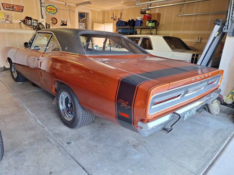

Fast forward to present day. The car is modeled after an R/T, but I wouldn't call it a clone. I didn't like the 500's chrome moldings so pulled them off, welded up the holes and painted it 2013 Challenger Toxic Orange (orange is the wife's favorite color, go figure). The engine was rebuilt by a local machinist that knows Mopars. It has a Hughes Engines valvetrain with a hyd FT cam; Icon pistons at about 10.1:1 compression, 440 Source aluminum heads, Eddy aluminum intake, 800 cfm AVS carb and Doug's headers. The 727 was rebuilt by a local shop and has a Frank Lupo Dynamics 3,000 stall converter. The 3.55's were swapped out of the Dart (it got 4.10s). Over the years I added the fiberglass hood and R/T stripe.
It makes for a real nice cruiser, but with the 3.55's the engine's at 4,000 rpm just keeping up with traffic. Honestly, over the years I've been debating whether to sell the car or get the 5 spd because I don't drive it at all out of town.

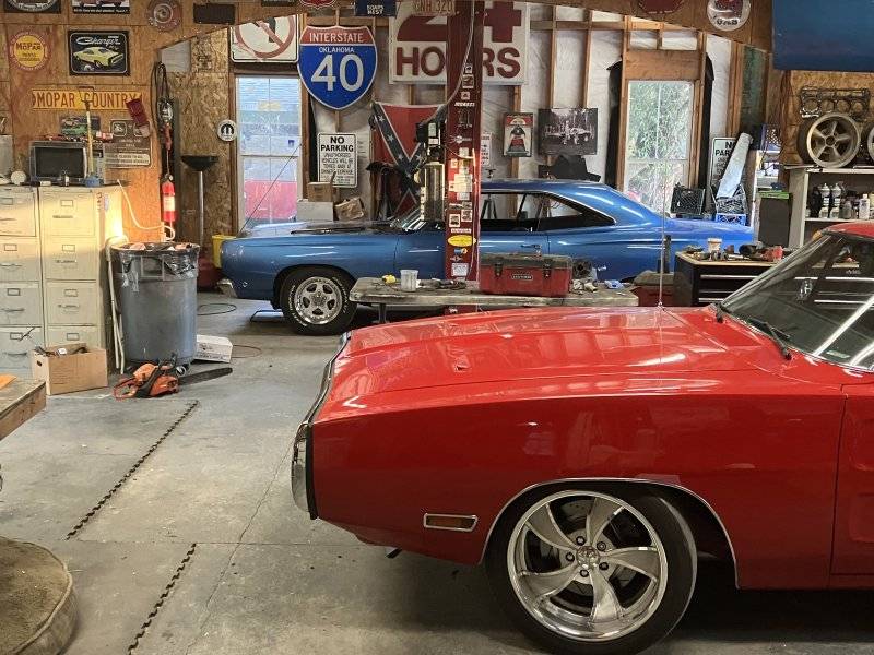

Actually, I left out a critical detail in Post #1. Back to the night we were watching TV and Maria practically begged me to get the Tremec, I texted Kern and asked him if I could use his lift for the project. He immediately replied in the affirmative. Otherwise I might not have pulled the trigger.
