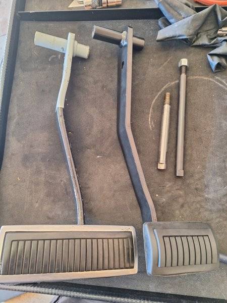

Here's the A/T brake pedal next to the SST. Notice the new pivot pin is almost twice as long.

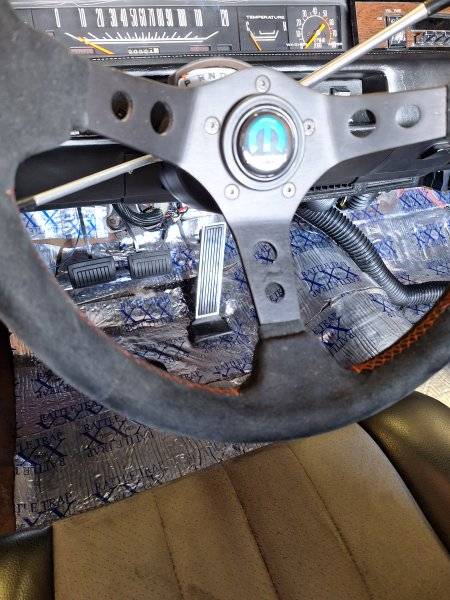

The kit comes with a clutch pedal stop (unless you're Greg). It presses in to the original brake cage.

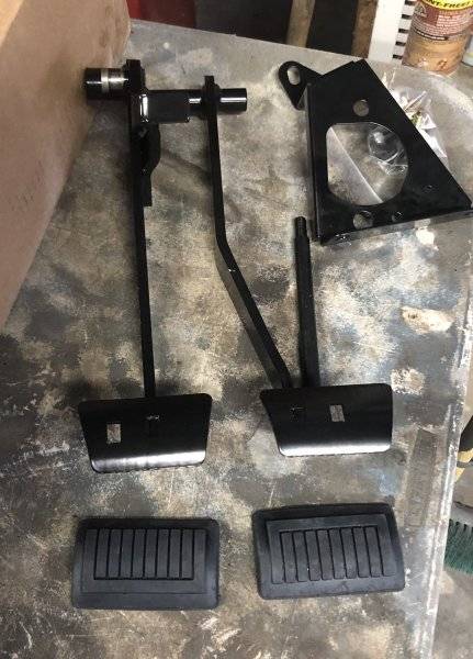

This is the brake and clutch pedal kit. The side bracket is a factory reproduction that bolts to the firewall. After installing the two new pedals and torquing down the pivot nut to 35 ft-lbs, the bracket flange attaches to the original brake cage. Mark the two holes from the side bracket onto the firewall, then remove the side bracket to drill the holes.
It's really important that you very carefully and precisely measure and mark the holes. In retrospect, I should have packed it in for the day once the pedals were in. At this point it was around 4:30 pm, and I'd been in the garage almost constantly since 9:30. I was hot, tired, and just a little exasperated that it had taken this long to get to this point. But, I had set a goal to install the pedals in one day, and so I pushed myself further than I needed to.

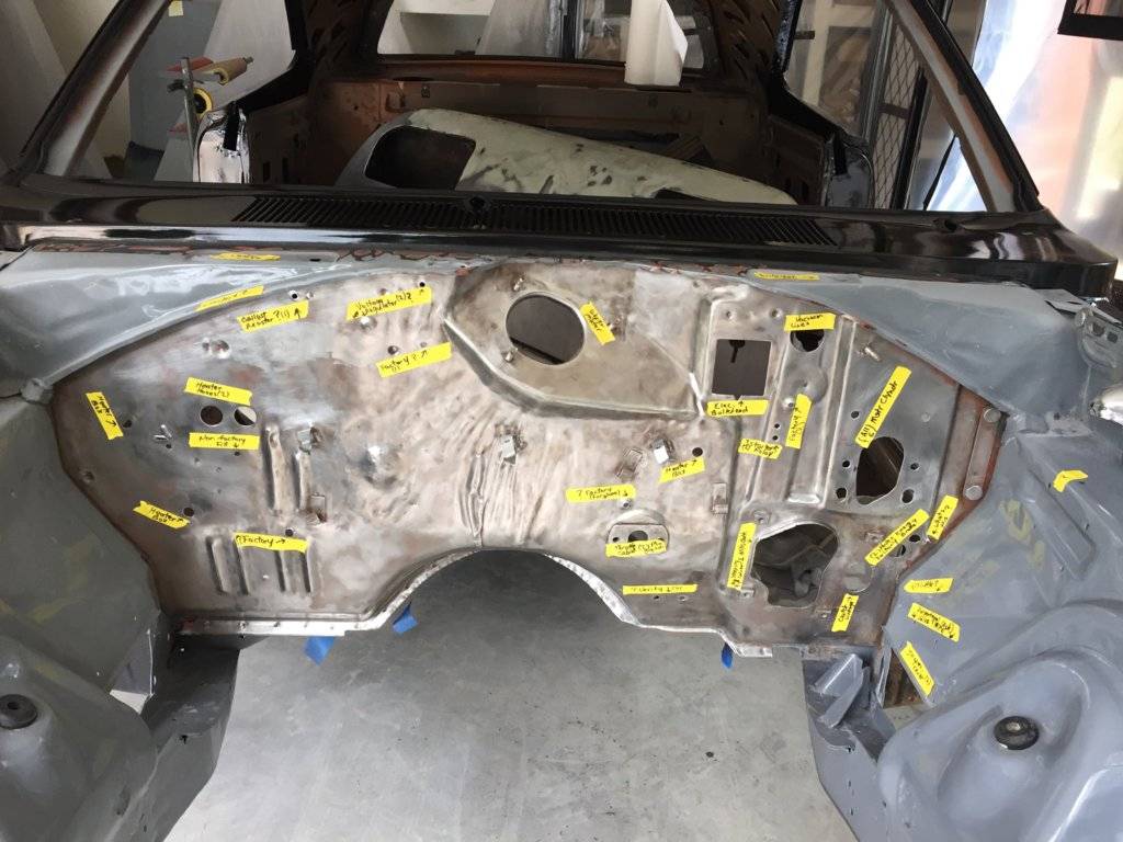

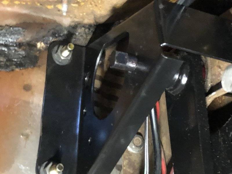

During the restoration, I wire wheeled the interior firewall and brushed on POR-15. Afterwards I installed the Fat Mat all the way up the firewall, almost to the bottom of the cowl. With the headers, I wanted to insulate the interior as much as possible. It proved to be a detriment for this install because unbeknownst to me, I covered up the bottom factory divot for attaching a clutch pedal bracket. Getting back to quitting when you're tired; it was getting late and I was pressing myself to finish. Instead, I should have taken the time to cut and peel away the Fat Mat to expose the bottom divot. The top hole of the bracket fit exactly in the upper divot, and the flange was tight against the brake cage, so I assumed the bottom hole was also aligned. Couldn't tell with the Fat Mat in place, should've taken the time to verify. Turns out, I drilled the bottom hole about 1/4" towards the outside of the divot. In other words, the bracket wasn't plumb. In the end it worked and the pedals and bracket are in and everything works fine, but it's not perfect.

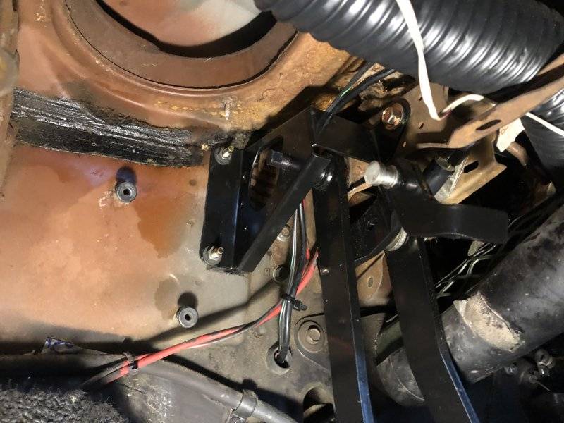

Here's what I was looking at. You can't tell from the picture, but the top hole is lined up with the factory divot (actually a protrusion on the interior side).
The lower hole is resting on the Fat Mat.

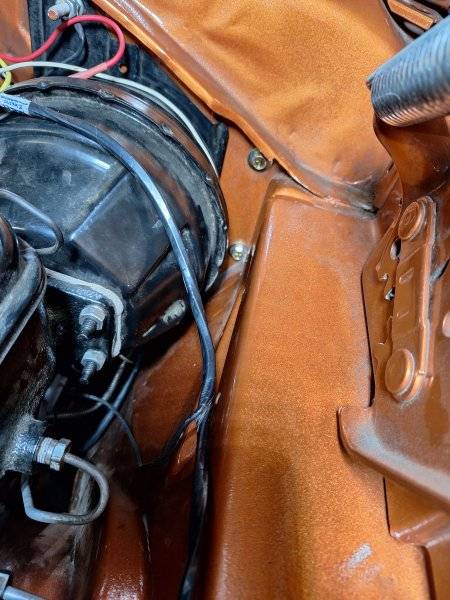

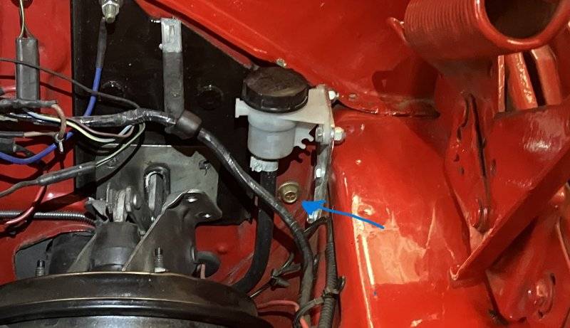

You can clearly see the two factory divots between the power brake booster and inside fender.
If I could do it all over again, I would align the two holes in the SST side bracket with the factory divots, and bend the flange that attaches to the brake cage if necessary to correctly align the bracket.

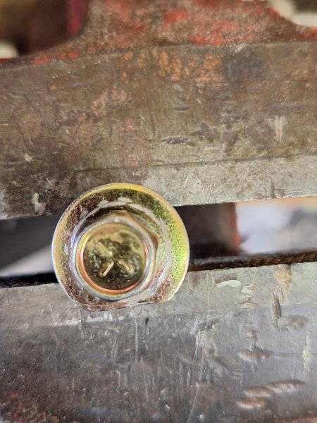

With the hole off by about 1/4", I had to cut off 1/3 of the bolt washer to clear the inner fender.
In the end, I finished installing the pedals in one day and everything lines up so it's on to the next step. It just took much longer than it should have.

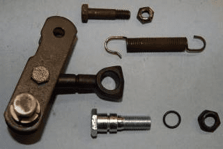

On the brake pivot assembly for 69 B Bodies, what does the spring do? I have it on my car, but it's so stout I can't get it back on.
Not much, it's supposed to prevent rattles...Clips to the pedal support bracket directly above the dog bone link & hooks in the groove around the dog bone... I use a hook style scribe to get ahold of the spring & pull it into place...

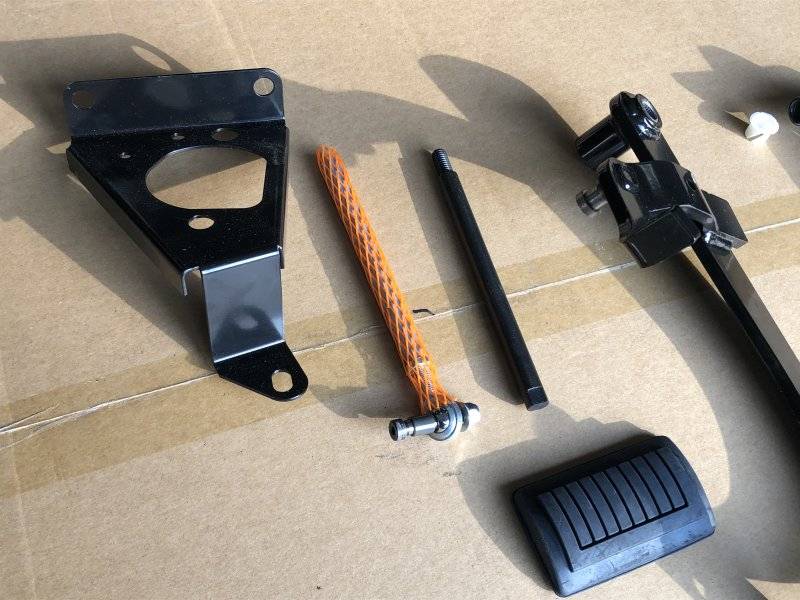

Here is what came with my kit.
Looks like I just used plain bolts to mount the clutch pedal bracket.
