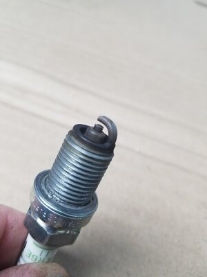

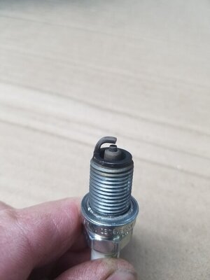

I’m surprised the 6’s are too hot. Can you snap a pic of one to see how it looks?

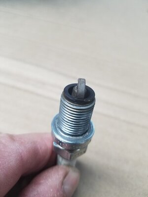

#1 plug. At idle and cruise it is running rich, and wot slightly lean according to my AF gauge. I need to get the timing back up before messing with the carb though. There is only 150 miles on these plugs. I do have a new set of the same ones. Maybe I should change them out?
Honestly they don’t look that bad. I’m wondering if maybe you got some **** gas. You don’t want to keep rattling it. I run 6’s in my 10.5 511 on pump premium with no issues. I tried 7’s once but they were a bit cold for my combo. I would put a set of 7’s in it for now but then I’d try to get rid of that gas and try some different stuff.

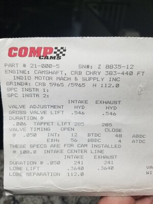

Cam specs?

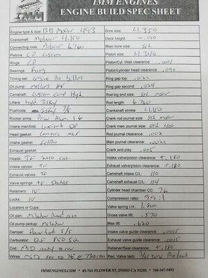

Cam card and a list of what's in the motor. It runs at a steady 190 degrees. I don't know what the cranking compression is.

Another thing, how are you guys determining when a plug is to cold?

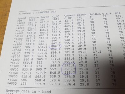

Dyno sheet. I see Brian wrote down that it is 9.9:1 compression ratio.

Okay thanks. As far as the plugs, You'd like the first 2 or 3 at most(on an ngk) threads be colored up. It's hard for me to tell from your pics, but in the top left one, it looks like the first two threads are colored? That's fine, at least really close. Tough for me to see on my old screen. But too cold would be, if there was heat coloring on only the first thread. If it was too hot you'd have that nice toasty brown sugar down to the fourth and beyond. Either way, it doesn't appear, to my eyes here at least, that your heat range is too far off. Especially not toward the 'too hot' direction. Now, I'm just a nobody but what I would do is cut the threads off a plug and examine the very bottom of the porcelain for your WOT ring. I would NOT be completely relying on the gauge...yet. If you have a nice little brown ring down there, around .100" in width, you're WOT mix is in the ballpark and your meter reading is okay. If it's a very small, very light-colored ring or too clean? You're running leaner than you want and the gauge is fibbing...13 may not be max power, but it shouldn't be so lean it rattles? These other guys will know far more than me on that....
You'll also be able to better see how much, if any, 'speckling' is in there---hopefully none! That would be piston material..
