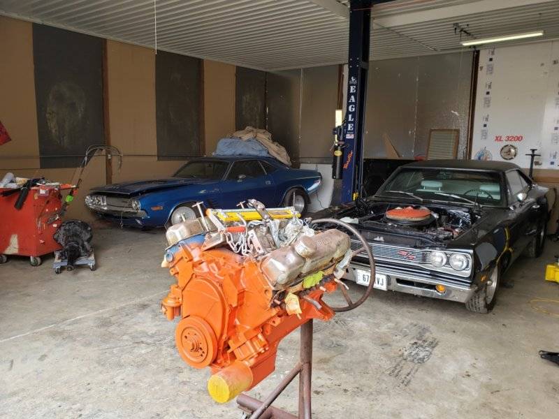

I got 69 coronet R /T with an air box on the underside of the hood. Has anyone ran into this with trick flow heads and intake? I can see its taller and going to be an issue. Looks like I may have to remove it but haven't got to that point yet.

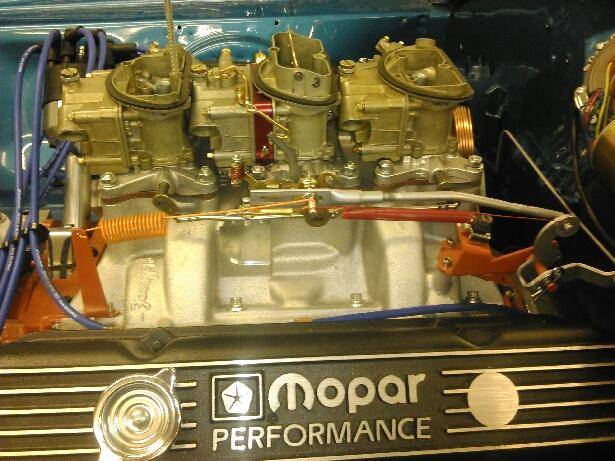

I can give you a measurement if you like for reference with a 6bbl.
PM me if I don't reply before Fri. I won't get to the garage till Wed.

The 6-bbl intake manifold shouldn't be any taller with the 240 heads than the stock iron heads. The 240 heads don't have raised port entrances. Did we use spacers on top of your carburetors to clear the air cleaner base? Something was going on there that wasn't quite right.
Yes we put a couple on to clear the A12 base. I also put the phenolic spacers in (.25-.375) under the carbs.

I measured 4.75 inches from the carb mounting surface to the valley pan rail surface at the front. That should give you a reference.
What is that dimension on your stock setup?
