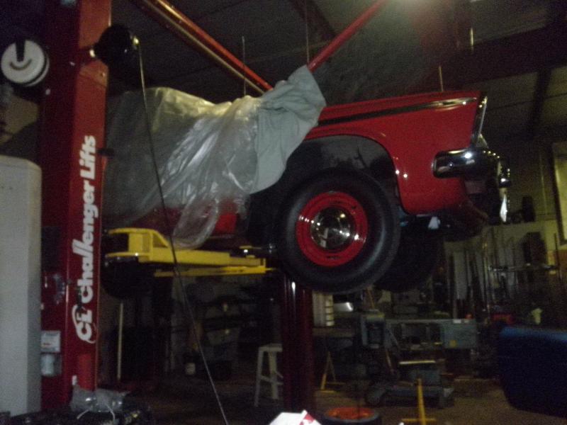

you could use one of these.....it helps even if you have to "rent" one
