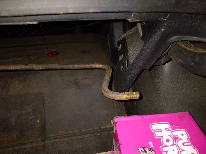

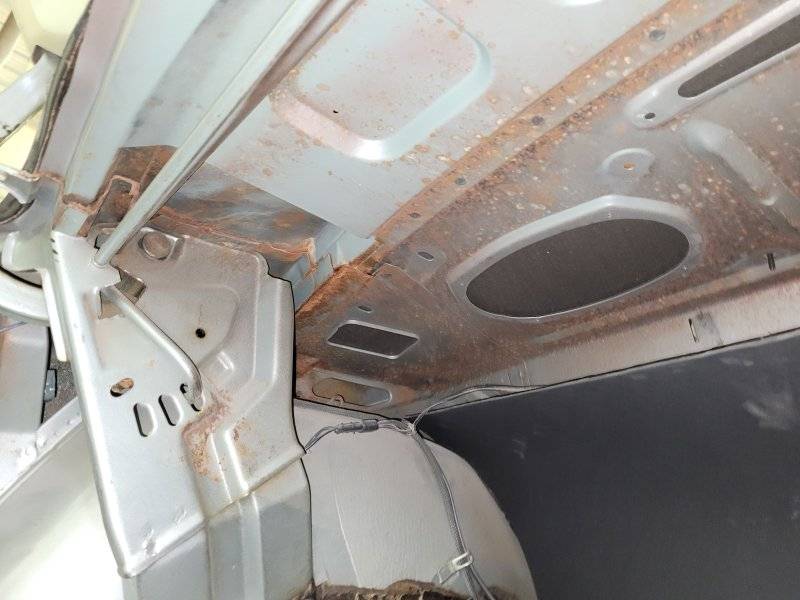

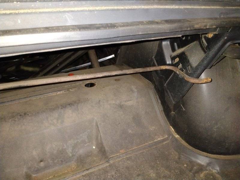

Question for the trunk lid torsion spring experts (or anyone who knows). I picked up a set of springs that were suppose to have come from a 67 or 68 b-body (don't remember which). I thought, and that might be the problem, that they would work in my 66 coronet. So, I got around to figuring out exactly how they install and what might be the best approach, and it looks like they are too short. So here's a few pics, can someone confirm for me that they are not the right springs for a 66 coronet (maybe a-body?), or that I'm way off base with the install position. They appear to be about 1 1/2" to short to make it from one hinge plate to the other. Thanks.

I would certainly think any 66 AND 67 Dodge and Plymouth "B" would be identical... I have a `66 here...I'll go look and maybe a pic. Also, I THINK I have a `67 spring loose out of the car...

If you do have a spring out of the car, would you mind measuring it for me? I'm pretty sure the springs I have are too short and must be for another application, A-Body I assume.
I couldn't seem to lay my hands on the `67 ones I have out of the car. I looked at the `66....plymouth belvy.. I got 44" cc to the hinge plates, and the rods are 47" or so, depending on just how you measure them. HTH, Lefty71
That sounds about right. I measured from hinge plate to hinge plate in my coronet and got approx 44", so I was guessing that the spring should be around 46" long. Thanks.
