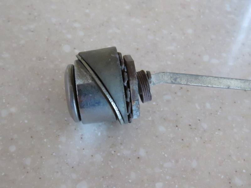

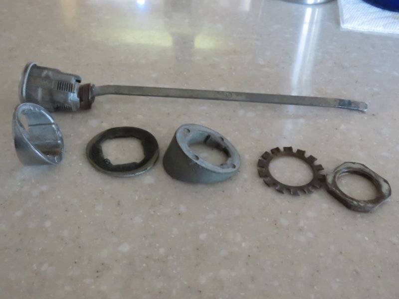

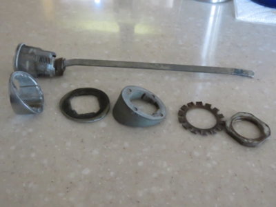

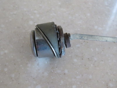

For those of you who like pictures --- here's the 1966 Charger trunk cylinder, wedged shaped escutcheon, gasket, wedge shaped spacer, washer, and nut.

So I was Missing the 3 pieces starting from the right , great pic. Pictures are worth a thousand words ! Works good and no screw drivers anymore
For those who've never removed the trunk lock cylinder, removing the tail light assembly is the only way to get good access. It's so easy to work when the tail lights are removed.
